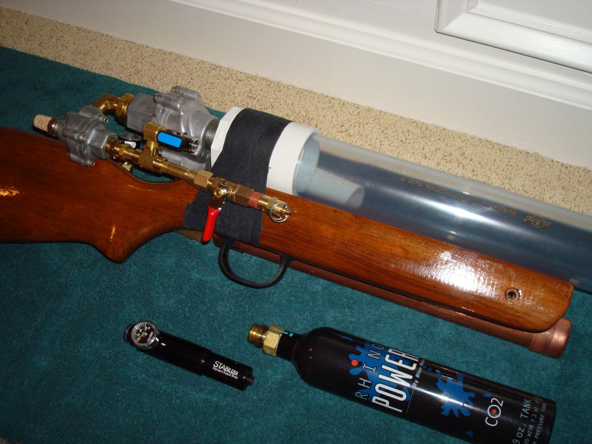

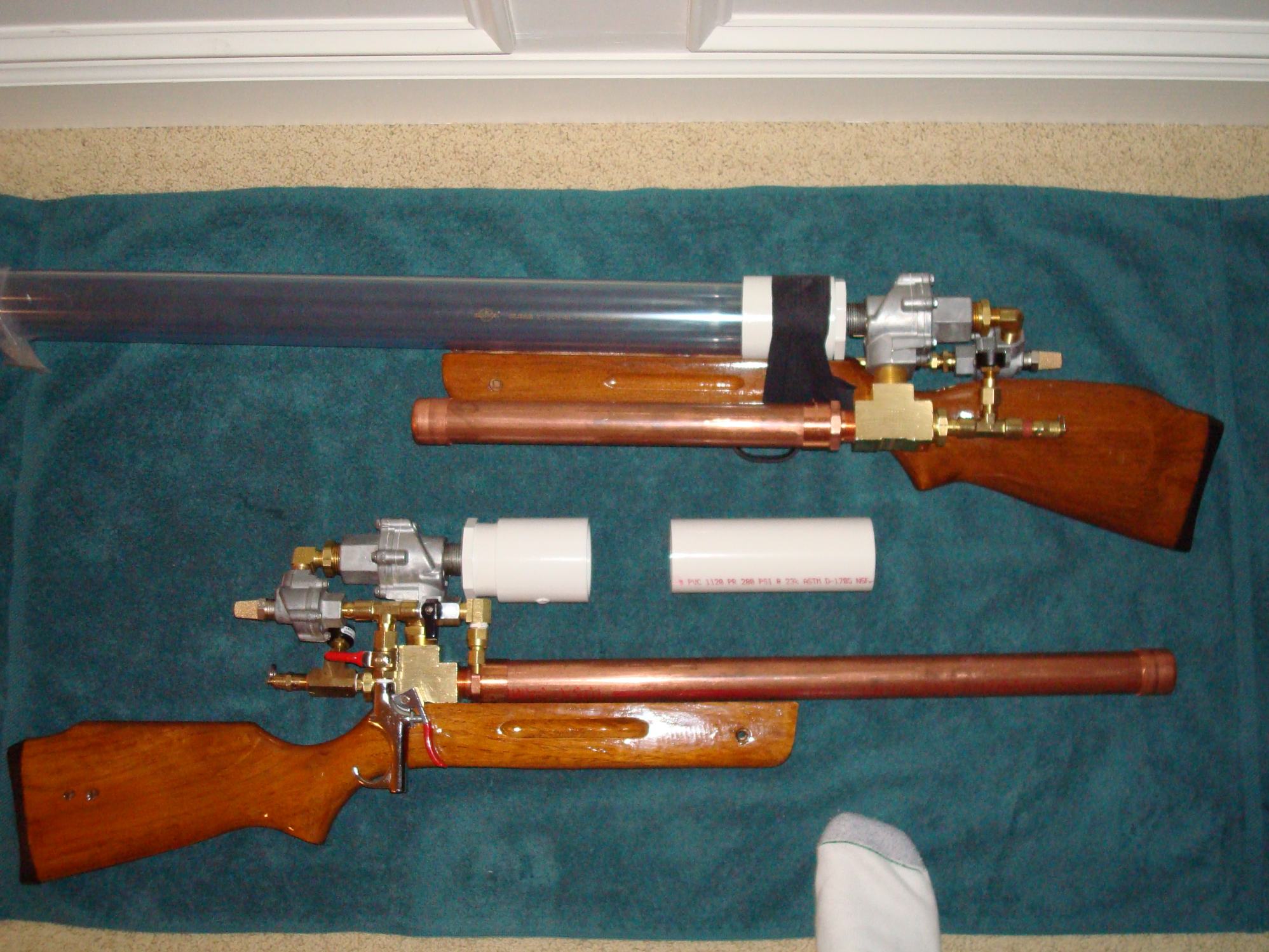

woohoo! got my McMaster order in yesterday, dry-fit the parts last night.
these are the next step in my progress with this prototype: http://www.spudfiles.com/forums/dual-qe ... 12691.html
showcase & details to come after this weekend build-test fest!
they're more purdy in person than these pics...
[edits: added GGDT file, leaking trigger assy. pic.]
[edit: added trigger assy mechanical picture (see "What A Find!")]
[edit: added barrel bracket & trigger pics]

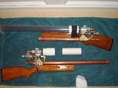

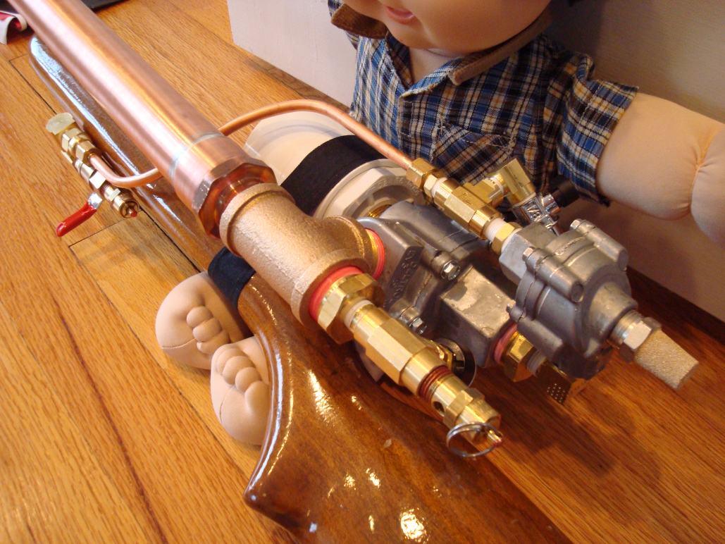

Two alternate designs...  Obligatory foot in photo.

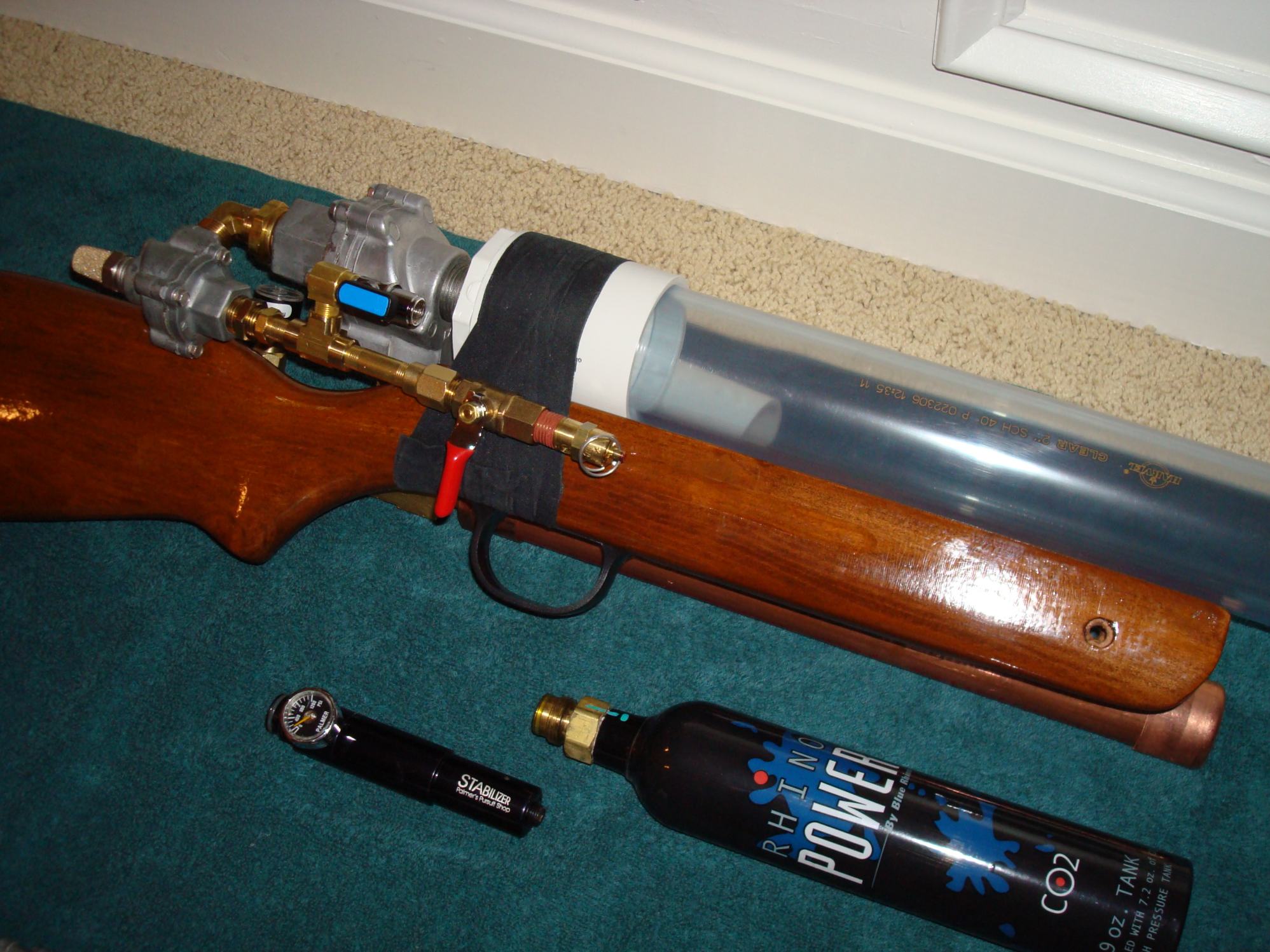

This one's my preferred design - will need to re-work the placement of the blowoff (which triggers the QEV's) to better connect to the gunstock trigger (however i decide to do that).
Nice thing about this design is that the trigger is still very comfortable whether mounted to the gunstock or not.  Also, the whole thing is still light enough to easily hold in one hand (and this one still has the oversized chamber still on it).

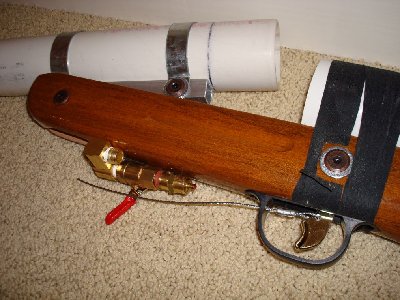

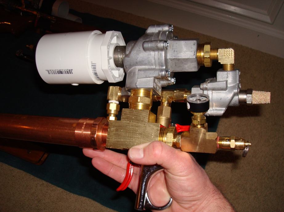

Trigger assembly on, but leaking from those darn compression fittings...   ...hello, old friend...

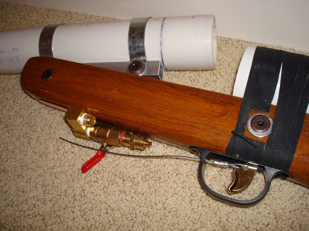

What A Find!!  <br />i was at the store to get flare fittings and found this for a trigger, including a way to connect it to the popoff valve (hadn't quite figured that part out till now).  hopefully it'll go together like i see it..!
What A Find!!

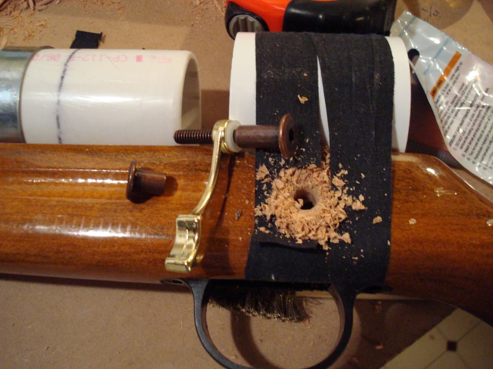

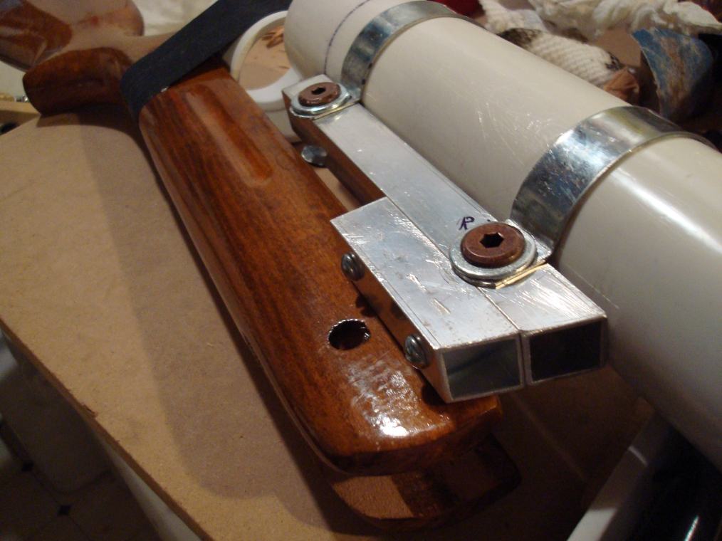

breakbarrel pivot &amp;amp; trigger in place.
breakbarrel pivot &amp; trigger in place.

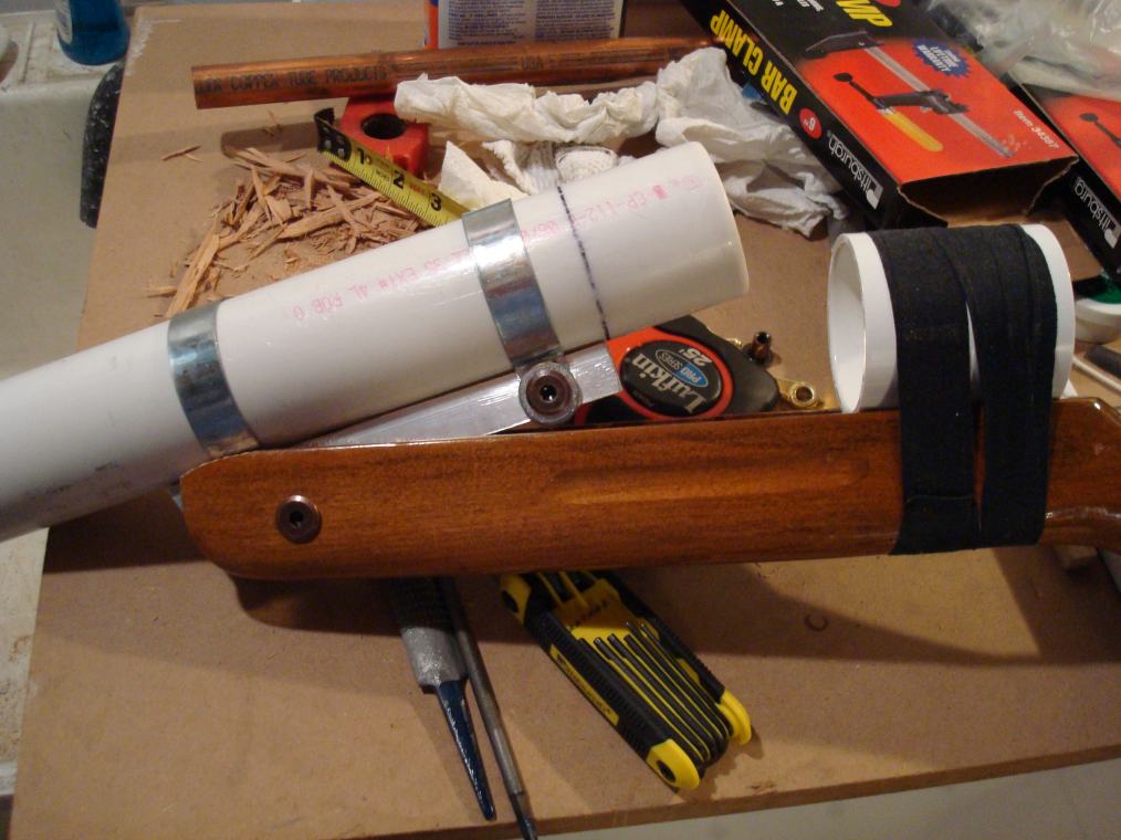

trigger about to be put in

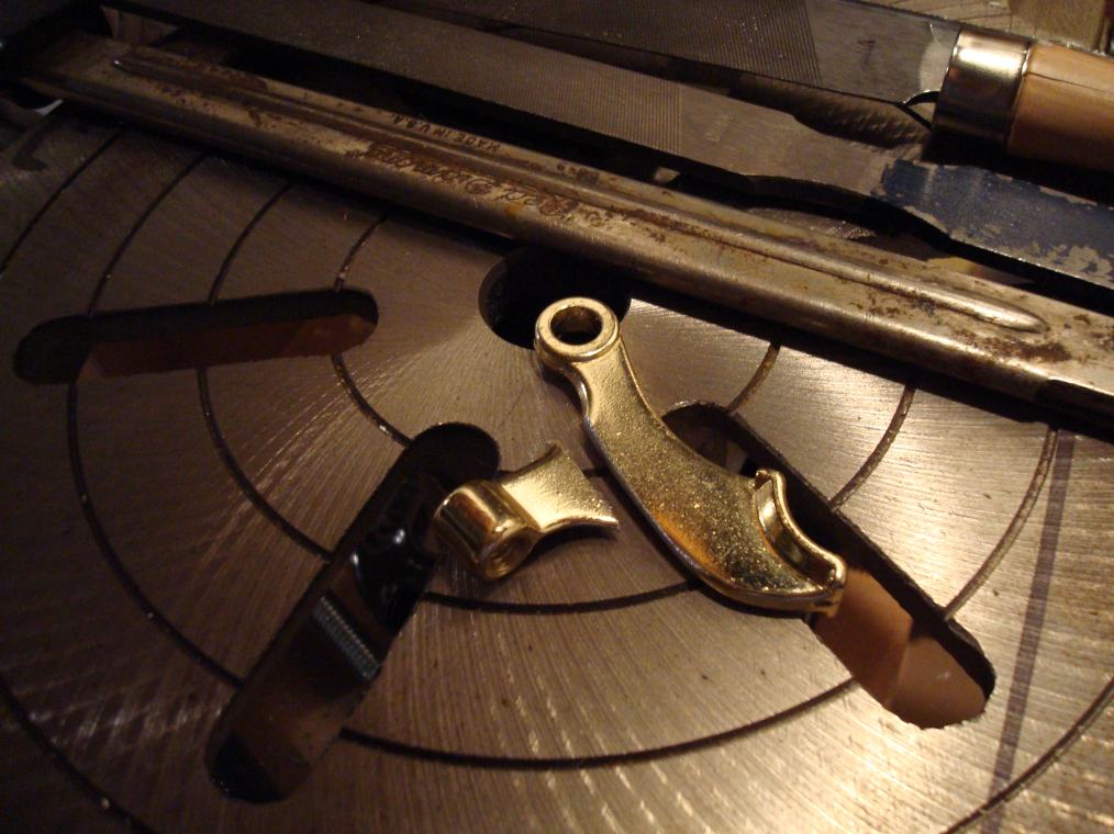

how i cut the trigger part (cut &amp;amp; filed)
how i cut the trigger part (cut &amp; filed)

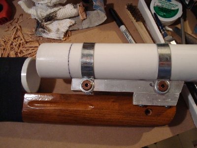

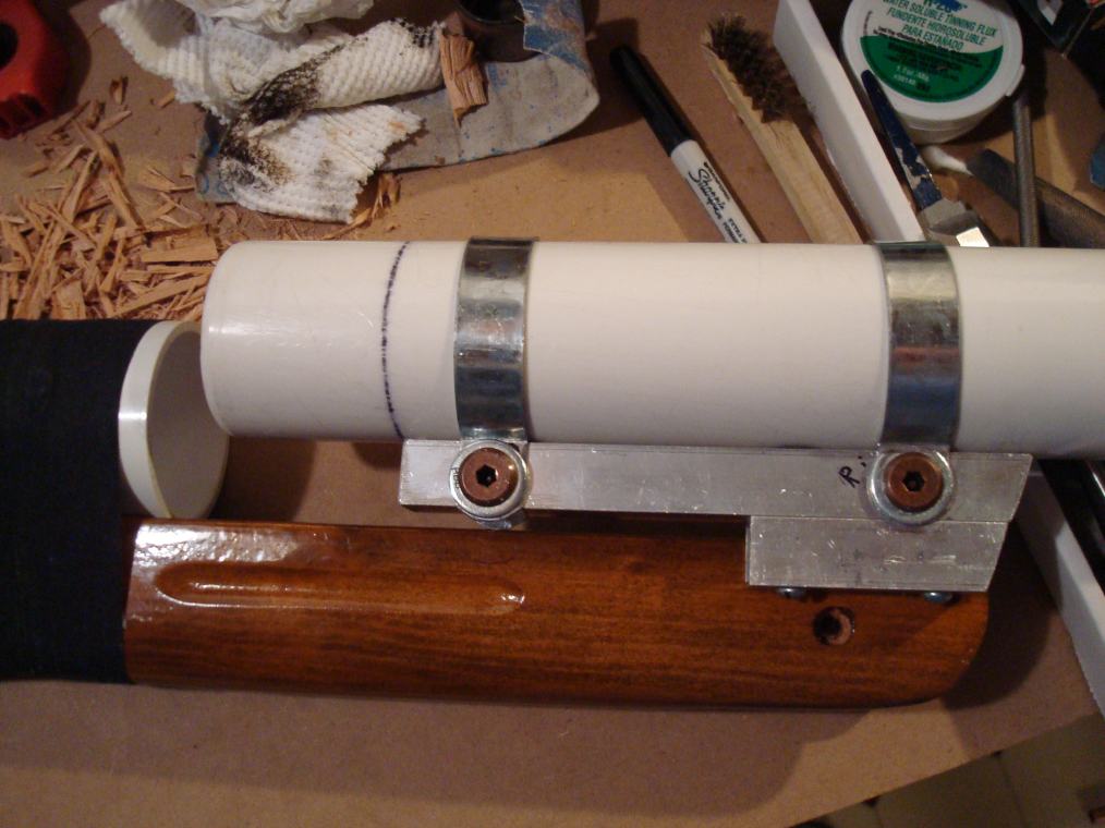

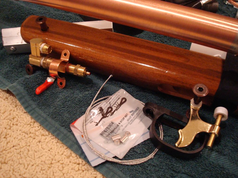

barrel pivot assembly in place

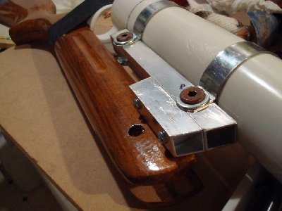

barrel mount pivot bracket

Dang that looks extremely nice. I like the steampunkish look of the tennis ball cannon.

Ahh the little QEV and pressure valve are so cute :P lol
Those are pretty cool... I once saw a 1/8" QEV, which was just funny...
The gun looks awesome! I love the clear barrel and stock.

My only complaint is that the chamber seems kind of small for that size barrel I would recomend something like a 3/4in barrel so you get some respectable velocity.
peeeto
Posts: 41
Joined: Wed Jan 02, 2008 12:47 pm
despite the high-pressure capable chamber, these rigs aren't for damage - they're for launching rockets at paintball games. copper for the chamber's just the lightest/cheapest option for me right now. PVC chambers not allowed.
the projectiles are 32g foam rockets at 160 fps max (for now - the local field is evaluating the max speed for this season - in other words, they're gonna shoot someone (volunteer(s)) at different speeds & stop when they cry... j/k you get the point...) some fields limit at 140, others 230. they've decided on 160 for the 1st scenario game this season.
if i can go higher later, i'll couple/sweat on more length...
oh yeah, and i definitely will be painting one of them - the one i'll be playing with. and, - don't smack me now - but i'll be painting the clear PVC barrel, too (i'll leave a strip along the side unpainted to see inside because i can never remember if i have one loaded or not!). i should have ~28" of it left over for later projects...
p.s. i did start to think about what V's i can get with a 1/2" barrel on it..!
p.p.s. oh yeah, i attached the GGDT model to the top post. it shows i should get the velocitiy i'm looking for at the pressure i want to run (90 psi with room to adjust up to 110psi - my self-imposed max). the GGDT model was calibrated with the prototype i mentioned in the top post.
