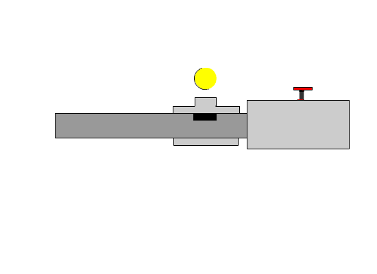

Hi I am kind of new to combustion cannons and I was wondering if breech loading was possible or if its not a very good idea
thanks
,sssssbooom
I was thinking like this
c cannon.gif (8.04 KiB) Viewed 2861 times

breech loading is available (and in my book, recommended) to any sort of cannon, so if you're wondering whether to do it or not, i say DO IT!!! :D

breach loading is commonly used in cannons. If I were to guess maybe 10% of the cannons here? For an example look at the one i designed. There's an animation along with an explanation of how it works.

a ball valve is another route that is pretty sweet and convenient to use. Simply drill a hole in the side of the ball valve big enough for the ammo. Here is a pic of the one I put on mine...
Of course yours in the diagram would work fine.... but yeah, I would definately reccomend some sort of breech loading...

ooo ya I forgot about that I saw how to do on youtube one time and I totaly forgot thanks this is some thing I am really going to try to do

just make sure your ammo fits through it... my barrel was 1/2 inch but the ball valve was 3/4. when you buy the ball valve take the ammo you want to use with you and make sure.
