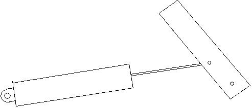

I may be way off here, as I am just a newbie in the pneumatic area, but I think if your pump had the same volume as your chamber that all you would do in one pump is double atmospheric pressure, which I believe would leave you with 14 psi in your chamber taking atmospheric pressure into account. Like I said Don't take this as a fact, I'm sure someone with way more background like Gipetto or someone will be able to give you better info. As far as it being easier to pump...... I drew a WAY simple diagram of how to use a lever to make it easier to pump...
I'm curious to see what others have to say...
Good luck, Lock

I like the lever idea. I was thinking of some type of pulley system, but this seems a lot easier to design.

Lockman has it about right, but it's not even that good. By the time you factor in cracking pressure of the check valve, your going to be lucky to get 10 psi in the chamber.
To get 100 psi in one pump, your pump cylinder is going to have to be roughly 7 times the volume of your chamber. That means (obviously) a cylinder which is either very long, or larger in diameter.
Do you have 7 foot arms by chance? :)
Didn't think so, the lever idea may provide enough force for the larger cylinder diameter. You'll have to crunch the numbers and see.
