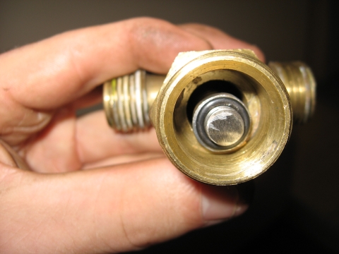

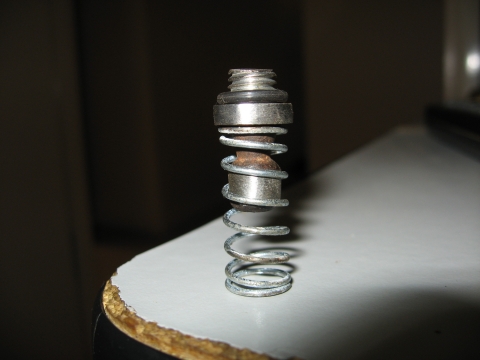

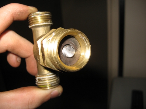

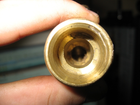

I just used what I had and could find in the shed. The main nipple is 3/4in compression into a 1/2in BSP thread, this is what gave me the base for the o-ring to sit and seal the washer. This valve could not be anymore simpler but I'll let you guys be the judge
Glue/solderless Pump check valve
I was in my shed looking to make a check valve for my new pump but I was out of money for new parts and I was just too damn lazy to go out and get some even if I did have the cash.

Looks like it should work.
I do like the "serviceable" aspect. How much pressure are you looking for?

Gippedo, I'm looking to hold 300psi with it.

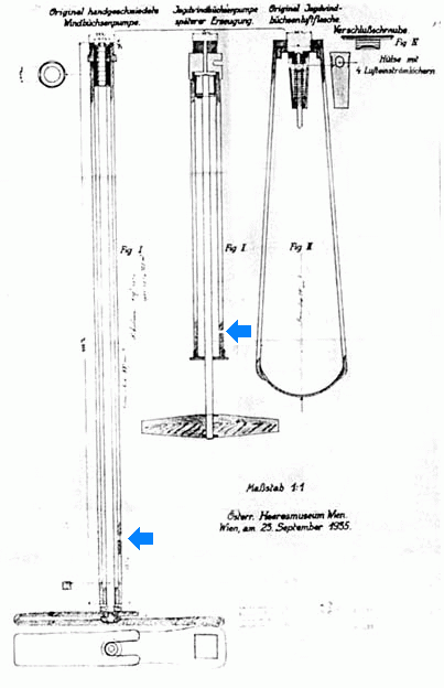

You could always do it the old fashioned way and use leather washers soaked in oil, Girandoni style
Head of the air pump from authentic museum copy of the Girandoni Military Air Rifle made from the above diagram. Two especially clever design features are shown here. First, note that the plunger, surrounded by several leather seal rings, can come right to the end to the pump, thus eliminating virtually all dead air space - an arrangement necessary to produce very high pressure in the gun's air reservoir. Second, note that the plunger head with its seal rings can be projected out of the pump body (as shown above) so that sealing oil may be applied directly to the leather seals. The seals may then be pulled into the pump body (as shown below) and a wrench applied to the lock nut- to precisely expand the seals to just the right seal and friction.

This is some what of a silly question but I'm not all that familiar with Garindoni pumps. I'm thinking that when the plunger is pulled right back, it goes back past the hole in the top of the cylinder which allows it to refill. Then when the plunger is pushed down, the air tight washers force the air through the check valve.
I'm thinking that the hole in the top also allows for the plunger to be pulled back too, ya wouldn't be able to do so if the piston head is air tight as it's supposed to be.

The check valve for the Girandoni is also the firing valve. It's basically an oversized schrader housed inside the air cylinder.
I like to incorporate my check valves into the gun body. The pump is then much simpler to make. Basically identical to the Girandoni pump but using a floating o-ring instead of the leather washers.
The Girandoni pump could still be extended without the little hole. The actual pump rod would have to be airtight to prevent that.
