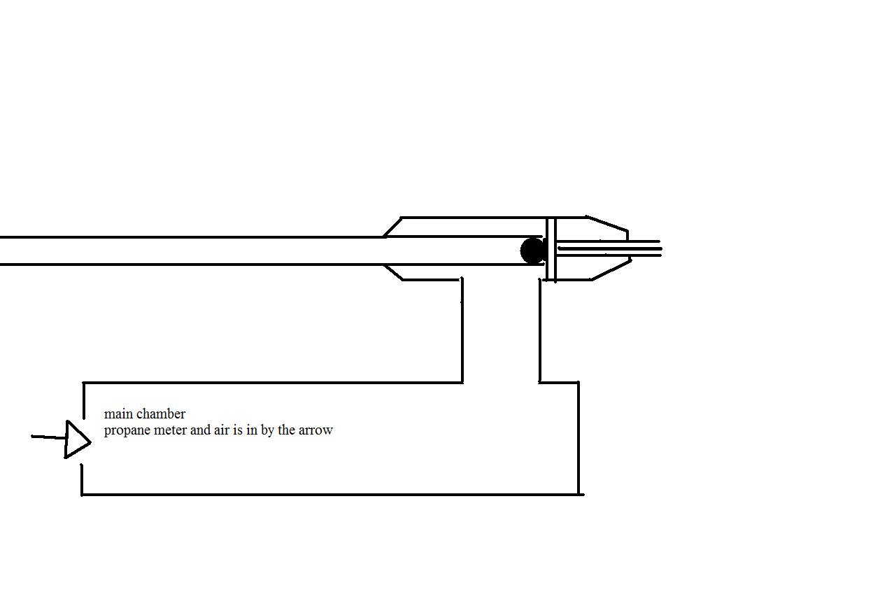

Chart, to get a spark in a metal pipe, just use a homemade sparkplug. With some HV wire, a pipe nipple (or barb, shrader, etc...), and some epoxy they're quite easy to make. If you can find the taps, you could even use a normal spark plug, but make sure it isn't permanent, because nothing on a hybrid ever works on the first try. And _Fnord's hybrid works a lot like a barrel sealer: you pressurise the pilot to a relatively low pressure (just enough to hold back the mix), then add the mix, and ignite it. The pilot air either vents through a pop-off when the piston moves back, or acts as an air spring to protect the piston housing.

oh, so there is only gas on the chamber side of the piston? so on ignition, the pressure would be greater on the chamber side?

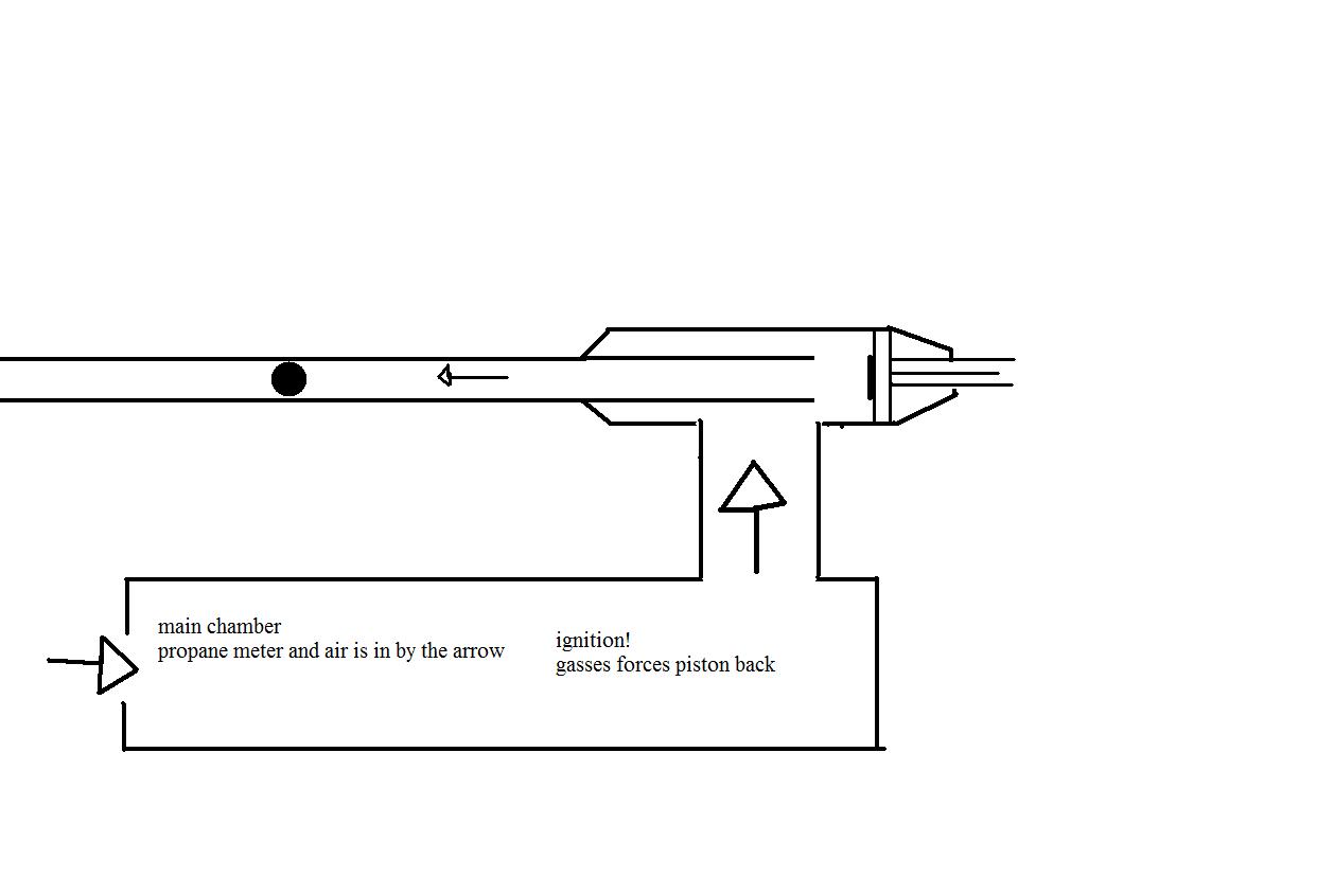

SpudFarm
Posts: 2571
i think it is pretty much like this just that the piston has to pilot itself when pushed back a little.
closed and charged
closed and charged
piston hybrid.jpg (35.52 KiB) Viewed 5621 times
open
open
