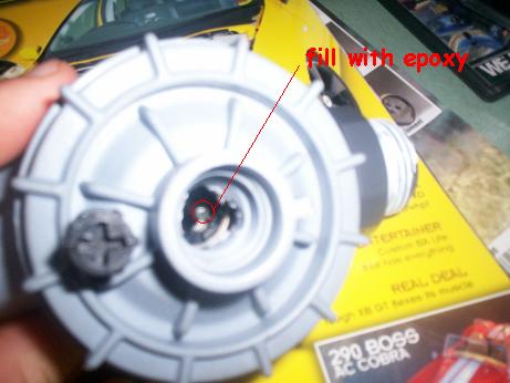

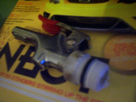

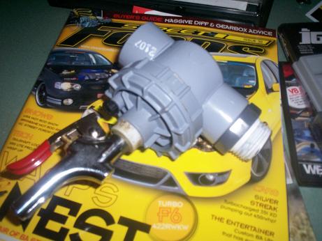

in between your valve and your solenoid you have a white plastic thing, this should unscrew from your solenoid and your valve. The way i modded this type was to epoxy a blowgun in the place of the solenoid like pictured below. I then filled the hollow guide rod with epoxy cut away at the plastic below where the white threaded plastic bit goes into (again look at pics).
Screw it all back together and voila :D
ps: my valve was 30$ from a irrigation specialist and it has about an 80 L/min flow rate which is quite high :D
