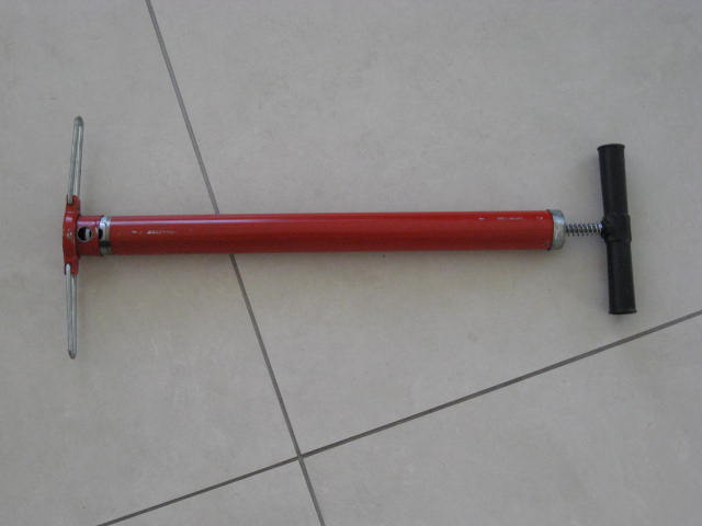

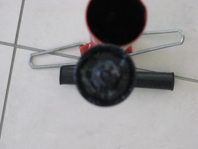

I bought a pump from Mitre10 a few weeks ago for about $15. It wasn't in a box and had no info. So I thought i'd see how high I could take it.
Got home, tried it out, hose snapped. Tapped a new hole, made my own hose, the whole thing leaks from the joints.

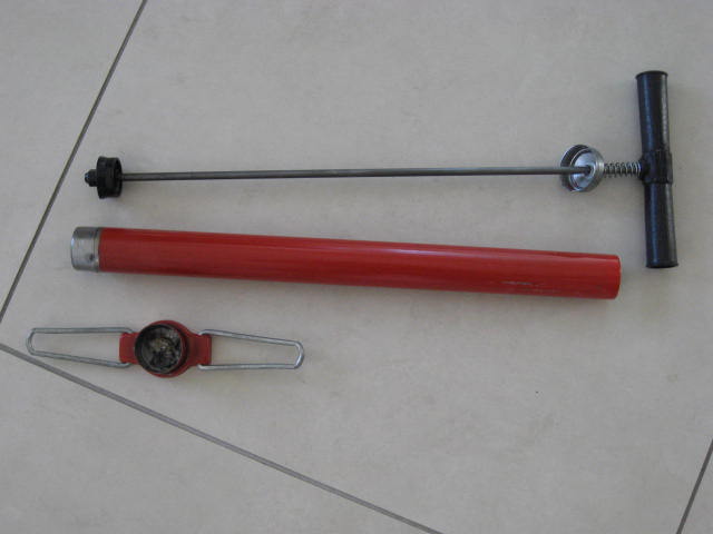

Today, I took it apart, all the joints came off easy with a hammer and screw driver, they weren't even bonded together in anyway. :shock:

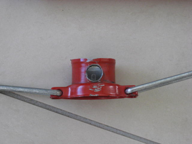

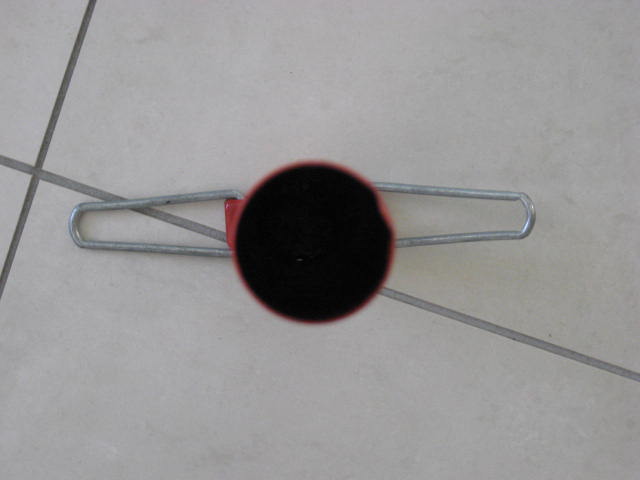

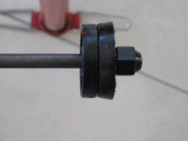

On closer inspection I realised it had no check valve, so all the air would just leak out the handle part. So I was thinking if I installed a check valve where I tapped a new hole, JB welded it in as well as threaded. (The metal isn't very thick) And then I would clean the whole thing, JB Weld the joints back together, put on a homemade hose for it and a schrader adapter and use it as a high pressure pump.
Think it would be safe up to around 250psi? I'm sure the metal wouldn't fail under 1000psi, but I doubt the pump and piston is sturdy enough to go much higher.

You're wasting your time. The effort it would take would be better spent on the right stuff.
It does have a check valve. The cup style piston works the same. It flares out as you push down.
The bore of the pump is too large for high pressure and the pump rod will almost surely bend.
Those things are made for pumping up balls and low pressure bike tires.

Its not one of the best pumps around you got yourself there.
And as it was almost falling apart instantly when you dissasembled it, it could also be named "sucky"
Maybe you are better of building your own pump from fresh new materials.
May look alot cleaner then a broken pump with JB weld all over it....

That piston would definitely have to be replaced. They have a tendency to fold over or actually rip in high pressure. If you were able to make a new piston out of epoxy that would probably work better. Your shaft is probably strong enough for 250 psi, but the plastic handle is definitely not. Those things break real easy.
Incorparate a bigger rod/shaft into the assembly.
