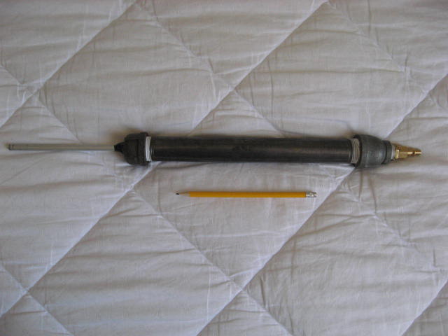

The power from such a crappy design impressed me, I have plans for a 3/4" chamber, 24" 6mm barrel and possibly mounted to a rifle stock.
I made this as sort of a proto-type. Just so I could get some experience with co-axials.
Specs:
1" Chamber 12" long
6mm Barrel 16" long
Wooden Dowel Piston with O-ring.
Until I make a high pressure pump, I have a QC on it for my compressor. I'll switch to schrader when I make the pump.
I know it's way over kill, but it's just parts I had laying around. And it needs a longer barrel, but I need to find a hobby store that stocks some.
And JSR before you go off about the Pilot Volume, there is next to none. The piston is housed in about 6cm of 20mm PVC that's sleeved in the metal chamber. The PVC extends back into the reducer, giving the piston about 7mm to travel. The rest of the pilot volume is taken up by some rubber which doubles as a bumper.
Picture time...
Over-View
Over-View

Very nice job Mr.C! i demand to see some damage! :x
elitesniper wrote:Very nice job Mr.C! i demand to see some damage! :x
At 115psi...pfft. I doubt it'd do anything worth taking a picture over. :)
elitesniper
Posts: 1090
should do pretty good damge :P mabey on some, sheet metal or i dont know... plywood? :)
Just got back from the first damage shots.
Managed to do 3 and a half (or 4, couldn't tell) soft drink cans at 105psi with a plastic 6mm BB. So i'm actually quite surprised at how powerful it is at such low pressures.
elitesniper
Posts: 1090
not bad not bad at all Mr.c but im not impressred yet comon dont do these baby pressure :) , i wana see some 200psi+
elitesniper wrote:I wana see some 200psi+
That's what i'm <A HREF="http://www.spudfiles.com/forums/viewtop ... 96">trying to</a> achieve :)

What did you use to get the barrel inside the chamber? Epoxy? some devious sleeving technique? or are there threads on the other side of the reducer...?
_Fnord wrote:OMG you have broked teh universe!!!11exclamationpoint!1!
^^^^CLICK^^^^
To get the 6mm barrel inside the chamber, I drilled a hole in the end cap and JB-Welded it in.
But I think you're talking about the 20mm pipe I sleeved partway in the chamber, it just fit perfectly, though I did have to cut a groove for the seam (from the galvanised pipe) to run down.

hey Mr.C how do you drill perfectly in the middle of the end cap? , i always move to the side just a little bit every time i drill something like that.
Novacastrian
Posts: 1603
First coax? Find that a bit odd Mr Modd man... Anyway it looks as though you have outdone the allblacks and are on a winner!
What happened to your hybrid plans?
elitesniper wrote:hey Mr.C how do you drill perfectly in the middle of the end cap? , i always move to the side just a little bit every time i drill something like that.
I didn't drill perfectly in the middle for this one. But I was pretty darn close. Just use a centre punch, like the thing DYI used to penetrate 1/4" steel.
It's like a huge nail, and you whack it with a hammer where you want to drill and it should leave a small indent, this gives the drill bit something to hold on to and should drill right at that spot.
