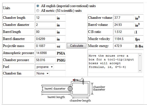

today i got my chrony and tested how good the EVBEC online is.
at a 5x mix with a marble i got 1075 FPS so the EVBEC was of with 109.5 FPS something i don't think is so bad... if i have measured the chamber and barrel very accurate it may have hit better.
i just want to let you know how accurate it is.
my pneumatic was at 690 FPS and the ggdt told me 800 so that was really off...
so what do you think about the numbers?

i don't remember hom much the ggdt said on the pneumatic but it was of ALLOT.
i got a chrony beta and did one shot from the hybrid (started to get dark) and it measured 1075 FPS or 327,7 m/s.
i shot at a dictance of 3feet with a marble at 5x with a 80in long barrel.
the pipe i used as chamber is 2" by 8" but is 12" with all the couplings.
i think the ggdt was of by 146 fps.
i used the same barrel on booth cannons and the burst disk in the hybrid was 5layers of heavy tape. (4layers doesn't burst at 3x) and it did not burst so clean.

Have you done a liquid volume measurement on the pneumatic to be sure of its chamber volume? What about the hybrid?
How accurate is the gauge on your pneumatic? With such an absurdly light projectile as you're using (3 grams), even a slight variation in pressure (in the pneumatic) or mix (in the hybrid) from what you think you're using could throw your results really far off.
How aerodynamic is your projectile? For such a light weight, it could lose some velocity from the muzzle to the chrony if it isn't streamlined.
How accurate is the chrony?
Could you show me a screenshot of the GGDT model, and give a link to the pneumatic?

Interesting; even without a fan, EVBEC predicted better-than-actual performance.
It seemed that for the longest time, the assumption was that filling the chamber with air was roughly equivalent to the use of a chamber fan.
Anyways, I'm not too upset with that prediction either - both the high-velocity and hybrid aspects of the system are rather iffy. Especially the high-velocity stuff.
That said, a couple of factors that EVBEC doesn't take into account which may have mattered here:
1) Flow loses. You have a very longer barrel than was typical in the tests, and a rough burst-disk rupture.
2) There may have been some leakage around the projectile
3) It's hard to push air through a tube at higher than (or very near) the speed of sound, so backpressure in front of the projectile will be higher than EVBEC pretends it is. (heck, EVBEC assumes the speed of sound in a gas is infinite!)

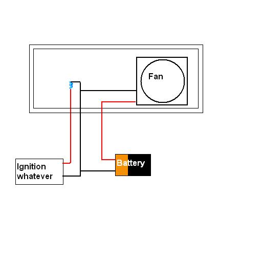

I might try a fan in mine, but I'd have to get another two holes tapped into the back plate, and the metering and ignition equipment won't be arriving until early April. If you have any success, it would certainly be worth trying though (and because we all know how fun it is to tap threads into 1-3/4" hardened steel plate...

I don't have a chrony, but any performance increase worth having will show up with increased kick or penetration depth. If I can't tell the difference, it's probably not worth it.
You can use one of the wires from your ignition circuit as one side of the fan circuit, so you'll only have to tap one extra hole (you won't need to tap anything if you aren't using the chamber wall as part of the ignition circuit; you can run the + fan circuit through one spark gap wire and use the chamber wall as the - ).

You can use the same wire from the high voltage circuit in the same way you can use the ground outside as part of a fan circuit.
Text doesn't work well. picture:
- I don't see why this wouldn't work provided you insulate everything properly.
