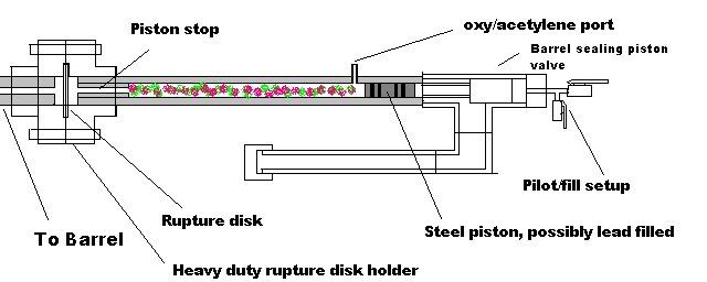

Here's a quick paint sketch. With a big enough lathe and some skills, it should work. The piston tube is aluminum, so that you can move the steel piston back into place with a powerful magnet. You could put the oxy/acetylene valve at the front, but then it would have to survive detonations. In this design, the only part being subjected to repeated detonations is the tube and the disk holder.
This isn't exactly simple, but your idea as it stands either won't work, or will be rather feeble (by my standards at least

Nice quick diagram DYI, it looks like a pneumatic on Steroids.
I too thought that a piston would have to be used but my design (in my head) was a little different.

nice diagram... yeah DYI this thing is defienatelly going to work... I wonder if it would work without piston or without rupture disk (i think it is not really needed - an o-ring or something would be enough to stop the projectile from moving down the barrel before acetylene would ignite) becasue what you proposed is acctualy a pneumatic acctuated this --->
when build according to your diagram it would have all the disadvantages of hybride (low rate of fire since the burst disk have to be replaced after each shot & the fact that there has to be proper air&fuel mix before firing)
I have little knowledge to tell whether it would work with acetylene being injected between a firng valve and the projectile and fired with a regular pneumatic spudgun... would acetylene ignite just becasue of pressure and as soon as the air/fuel mix would get right?
