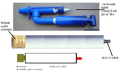

taz22
Posts: 101
Joined: Thu Mar 02, 2006 2:10 pm
iv thought of this design. deh quick connect could be something els, buth o don't know what:S

FiveseveN
Posts: 337
Joined: Fri Oct 14, 2005 5:48 am
Location: Nowhere
The idea of a compressed air CARTRIDGE is to use it for one shot only, then replace it with another one :)
@taz22: that being said, why would you use a semi auto piston?

taz22
Posts: 101
i'v used tis 1 becaus it was the 1st gun that came up in my mind, with a male quick connect:D
