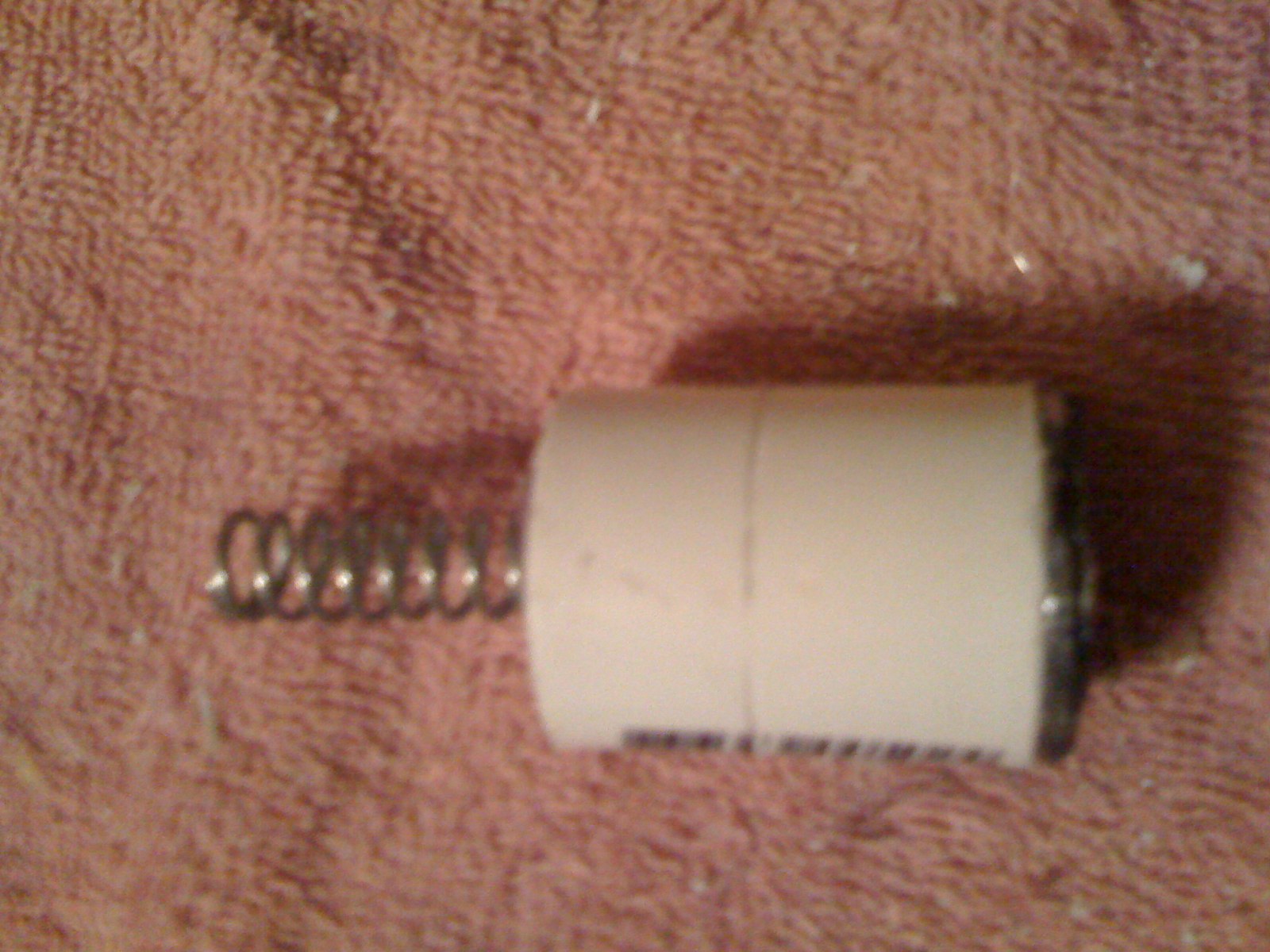

Hey guys, I found this site a couple weeks ago and it's really been helping me out, but i can't figure out why my piston (third cannon, first pison attempt) won't seal on the barrel.
it's sortve a coaxial, the barrel is mounted inside the fill chamber.
i'm using a schrader valve to fill, so i stuck a spring on the piston to help it start sealed. but no matter how much i compress the spring to start (by extending the surface it mounts on against the back of the pilot area) it won't seal. i did manage to get it to seal once by pushing really hard on it with my hand, and air couldn't be blown through the barrel.

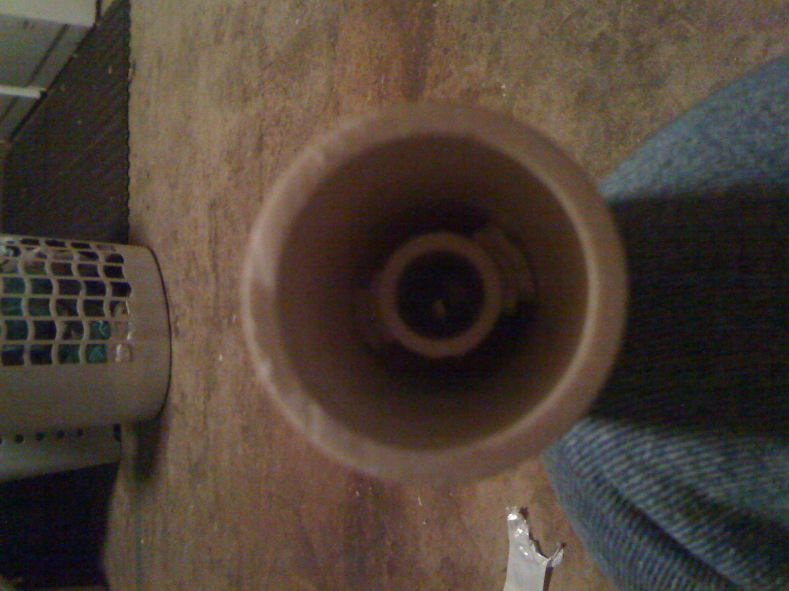

my best guess is that there's some imperfection on the sealing end of the barrel that is preventing a seal. im using neoprene washers from home depot, but theyre pretty thin. someone a couple pages back had thin neoprene too but his was working.
im planning on building a larger version once i get this working, with 4inch pvc for the fill chamber and 2 or 1.5 inch inside for the barrel. this one is 1.25 and .5, just cause thats all i had laying around

For a start get rid of the spring, you don't need it. Your guess with the end of the barrel not being perfectly square to the sealing face would have to be my best guess as well, it is going to be difficult to rectify the problem if you can't get to the barrel end.
It should also have a convex end and not be flat, this helps to compress the neoprene and form a good seal.
Is your piston hollow? The pressure may be expanding it and stopping air getting past into your chamber. If this is the case you may want to fill it with epoxy or similar.

it could be an uneven pipe cut or the sealing face could be getting sucked into the barrel.
what pressure are you using it at? if its below 30 psi, then you may just need more pressure.
i like to epoxy my pistons to the sealing face so it doesnt get sucked into the barrel.

i used the spring because i was worried that since i'm filling with a schrader valve the volvume of air coming in wouldn't be greater than the total area of the space between the piston and the walls, someone was talking about that in another topic.
so i should sand down the outside edges of my barrel a little? i wasnt thinking hard enough when i bought the fittings for this one, shouldve picked up one of those threaded separating peices, forget what theyre called.
the piston is some type of sleeve, exact same size as 1 inch pvc which i thought was kindve weird. its got a .5 inch piece of pvc inside, the space between is filled with hot glue, and theres a quarter sitting on the edge inside that supports the spring, front half is filled with hot glue too.
and the air is coming straight out the barrel on the first pump. no pressure ever gets build up, i havent even epoxied the barrel/chamber and fill parts together, which is y i can still get to the piston. but it leaks out the barrel before it has a chance to push through those joints.

As nova said I think your barrel is uneven.
I find the best way to slove this is to stick a coupling on the end. I do it on all my pitons to make sure they are perfectly sqaure.
I reilize you cant reach into it to solvent weld it together so just smother some epoxy on the inside of the coupling and stick it on
it would make the piston travel distance shorter so before gluing it just stick it in there dry fit and test it. If everything works alright go ahead and stick it on.

I always use uncut pipe as sealing barrel end.

If you suspect the sealing face is "not square", you could replace your gasket material with peel and stick sandpaper.(available in the autobody section of most stores)
Rotate your piston against the barrel and sand to perfection.
The coupler MIGHT impede airflow. Sanding to perfection will not.
