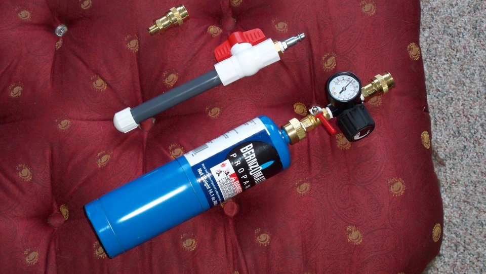

Also as I've mentioned before, consider going to metered propane to fuel this baby. Here's a picture of the suggested metering system. Tap a 1/4" NPT hole through 2 layer of PVC (through a coupler and chamber) and install the quick-connect. To use, charge the "hypo" from the propane tank, then take the hypo to your gun, snap in, open the valve to inject your fuel load, close valve, pop it off. You could also make several of the "hypos" and have them charged and ready to go for relative rapid fire....they are pretty cheap to make.
