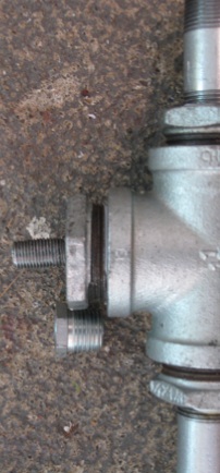

This is the front. I cannot thread the nipple on the inside of the bushing because the threads on that side of the nipple are damaged.
Bushing Tee.jpg (39.46 KiB) Viewed 1773 times
Here is a closeup of the tee, I guess I will have to either cut the barrel or try and pull that epoxied nipple off.

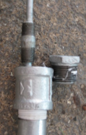

Here you can see that the threaded nipples (which are epoxied on) need to be attached to the coupling and bushing with threaded bushings. I should have epoxied it together with the bushings on  the barrel section, so now I need a way to get that bushing where it needs to go.

Massive tee :shock: Why not a new nipple? Is the chamber a nipple? I should have a vid soon of my almost completeled gun.

Yes, the tee is massive (1.5" I believe), It needs to be so large because it holds an 1/4" tee seen in the picture I will attach here. Every piece of pipe on there is a nipple, the ones on the barrel are epoxied on there, I would rather not epoxy them back on if possible. I look forward to the vid!

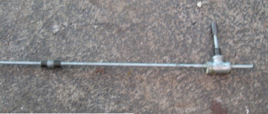

Here is the 1/4" brakeline barrel, all fittings on there are epoxied with marine epoxy. I might be able to pull those nipples off, I am not sure how dry they are.

Sorry to double post, but I do really need some advice on this problem. The only options I can think of now are:
Cut the barrel and put bushing on, glue barrel back together somehow.
Try and slide nipples off (might only be possible for the one above the tee)
Epoxy nipples into larger bushing (my least favorite).

Why did you epoxy it? Teflon tape?

So you can't unscrew the fittings with a big pipe wrench? Have you tried adding a few feet of steel pipe on the end to get more leverage?
I may be missing something, but why don't you just heat it up to the point that the epoxy melts? Doesn't seem too difficult, but be sure to do it outside.
kablooie
Posts: 188
Joined: Sun Feb 18, 2007 8:21 pm
