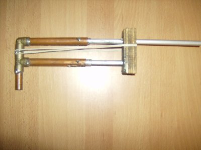

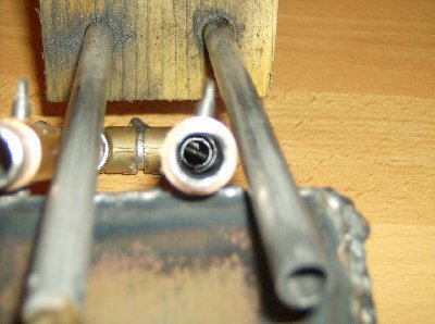

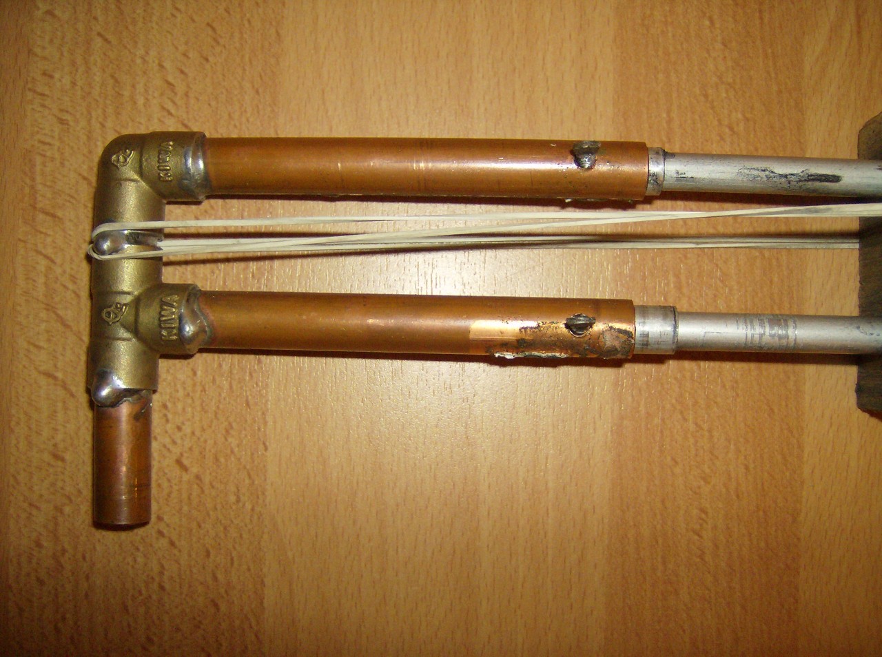

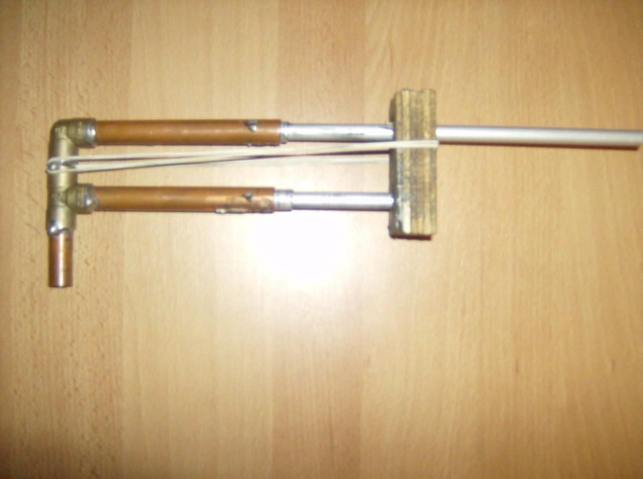

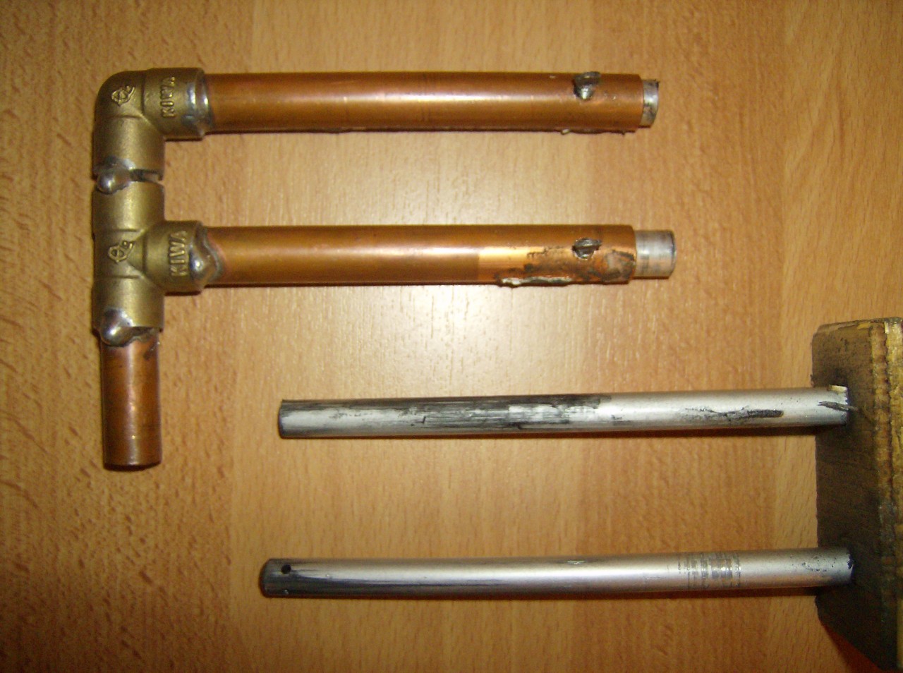

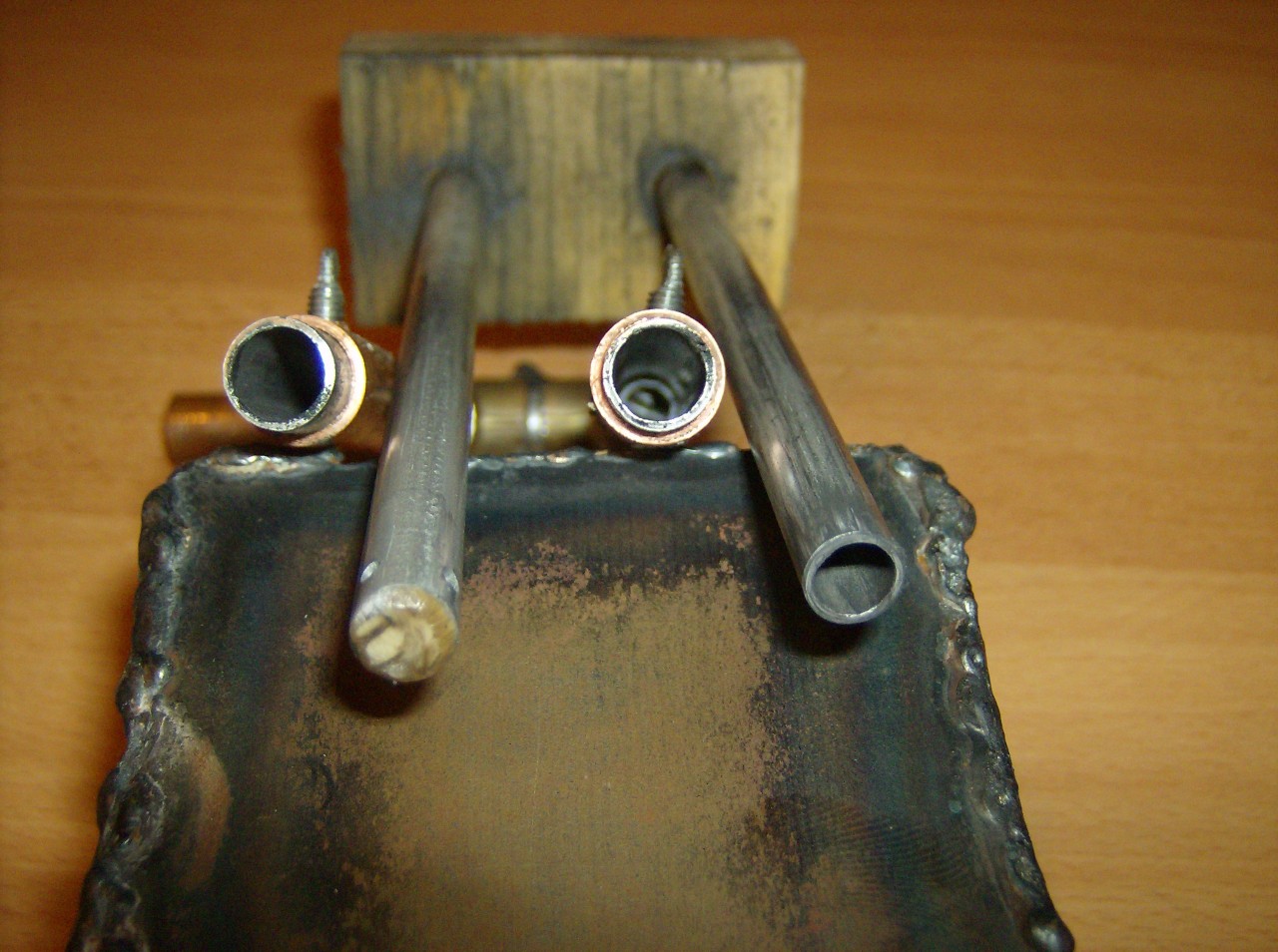

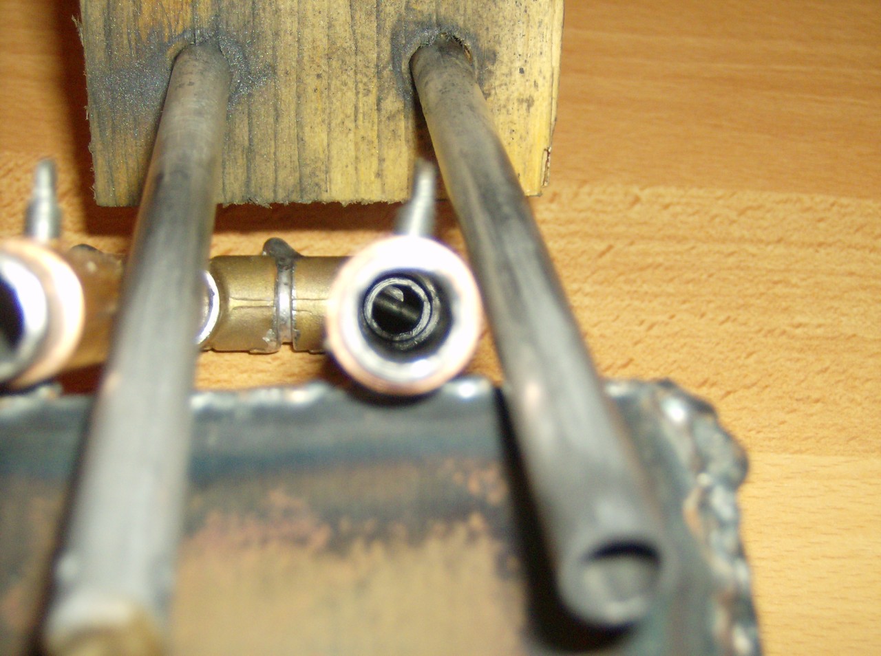

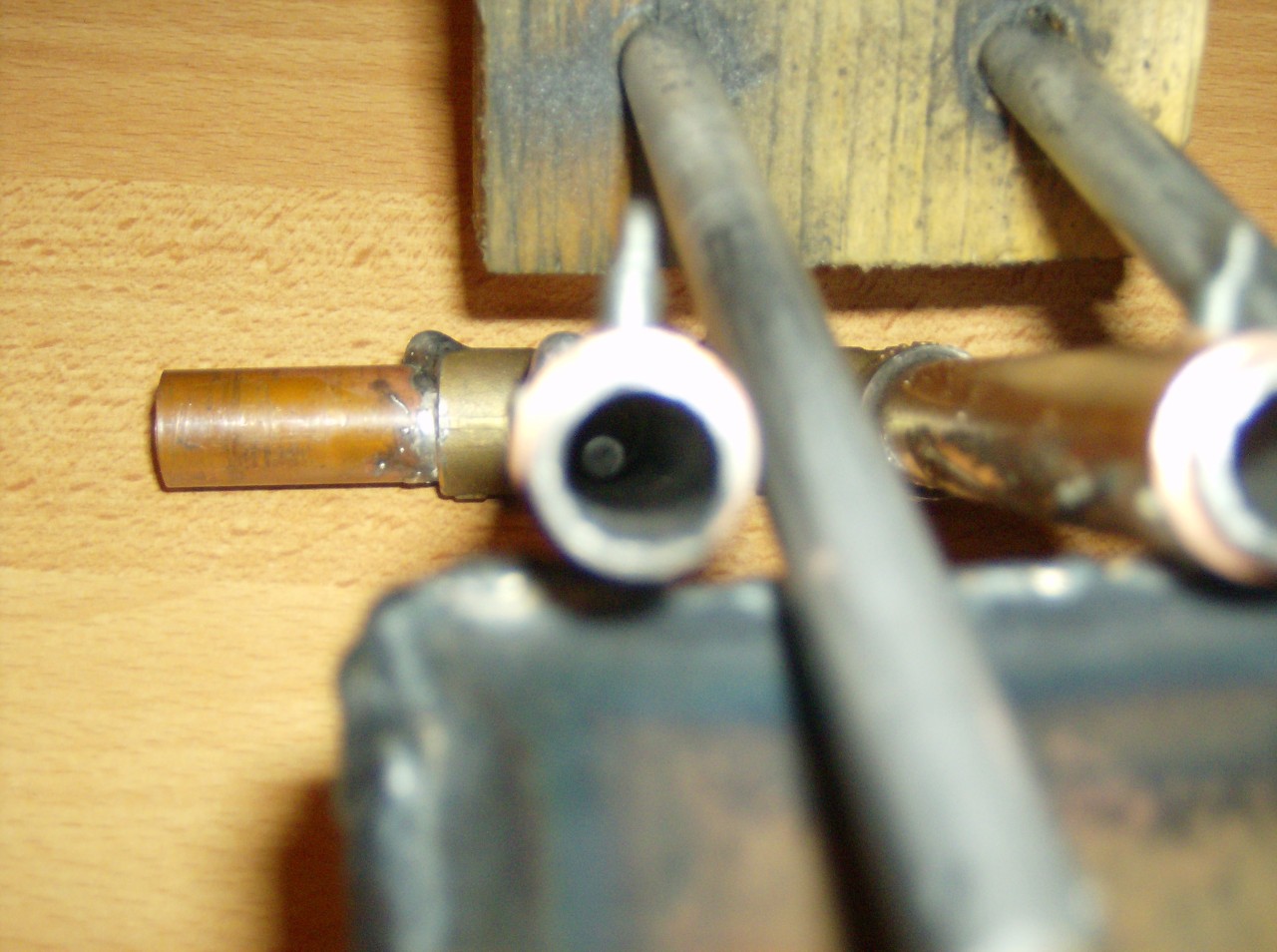

This is the ultimate automatic bb gun prototype. I still have to add the bb magazine pipe and trigger. But this is a good start. Atm the gun only works from a range of 6-8 bars, I am ganna try to increase this range by changing masses and spring tensions.
The bottom shorter tube is there to recock the system (it is sealed as shown in the pics), the top tube is the barrel and has a seperate. The tube that you c in the video is connected to my proud'' bottle setup as used on different guns I made. I the slowmotion part of the vid the framerate was too slow to register the real motion, thats why the your hear more then you see:) Enjoy Btw the framerate for the slowmotion part is too low thats why it looks weird, everything runs pure of the bottle.
automatic prototype staked tube (with vid and FLASH swf)

so does it work by the lower tube going forward, which slided the barrel forward to load it, then the rubber band closes it and it fires?

Thnx. It works similar to my older type of bb gun. This time I have 2 valve tubes instead of one. The bottom tube is used as a cylinder and the top as a barrel. When the whole hits back because of the elastic band the barrel shoots and the bottom tube gets full of air and recocks the system.potatoflinger wrote:Wow, that really sounds great!

Thnx. Plz look above for explanation, but yeah its something like what ur saying.hi wrote:so does it work by the lower tube going forward, which slided the barrel forward to load it, then the rubber band closes it and it fires?

and yay i finally get how your auto prototype works lol, may took me a while but i'm slow,
1. Rubber band pulls back to push into poppet valve
2. the tube below has a spring which is abit stronger than the rubber band
3. spring below recocks the barrel forward, and rubber band pulls back again, and it repeats itself.
Although it's prone to jamming but if you can put the hammer in the right position then it wont' jam i reckon. . and the trigger should be easy, u only need a "sandwich" thing again with a trigger jamming the rubber band, and when u pull it, let it rip...
You're a Genius would of never thought of that, I love it XD
It's Nerf or Nothing.
The bottom tube also has a valve just like the top one with the barrel. When the bottom tube hits the valve some air is let out. This air pushes everything back forward (piston effect) as the bottom alu tube is sealed. It works like this gun:littlebro05 wrote:well it seems like a semi-automatic airsoft gun, cause ur not cocking it really... but if ur implying the trigger recocks itself, then i get what u mean... i'll just call semi-auto anywayant wrote:Btw the semiauto gun u are talking about is actually not really semi, as in you have to recock it yourself :S But yeah rate of fire is pretty high as you can c on its vid.
But my design now has a barrel so it can actually shoot. The one in this vid is fake'' as the barrel is clogged. (I made it 4-5 years ago).

hmm when u say 2 valves it doesn't sound air efficient... and so the rubber band isn't too hard?
and i reckon to decrease the weight of the barrel not sure if it'll work, you should cut the barrel moving back wards shorter, connect a 10mm (8mm diameter inside) barrel by putting it inline with the moving 8mm barrel (6mm diameter inside), so the 8mm barrel is moving back and forth and the 10mm barrel is stationary....
although i have no idea if that'll affect the accuracy, but i reckon it might increase the rate of fire... well just an idea XS
