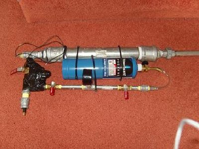

Here it is finally after alot of problems. thanks to everyone who helped me.

very nice job. very nice job indeed.
some questions though:
why so much electrical tape?
and... source of ignition? stun gun i presume

wow kinda reminds me of my hybrid :)
do you got any numbers? ;)

The huge wad of tape is a nice addition.

Great job
some specs would be nice though
It is actually black duct tape. it is the only thing i could find to attach the electric bbq lighter.
I haven't shot it yet. I will tomorrow. I'll post damage pics then.
the chamber is roughly 13" of 1.5" sch 40 steel
barrel 36" .5" sch40 steel
edit: changed chamber from 18 to 13"

bigbob12345
Posts: 1516
barrel could be a lot longer(atleast 72in).
I would also recommend a larger bore barrel with a chamber that size, A 1in barrel should work good with it.

its a little harsh on the eyes, but if it works it works!
Yeah I am trying to find a better way to attach the bbq lighter and some way to hide the wires. I might just cut them shorter but they have the tips to attach to the bbq lighter. HOw would you attach the propane tank other than zip ties?
