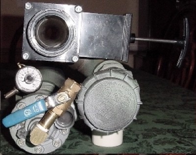

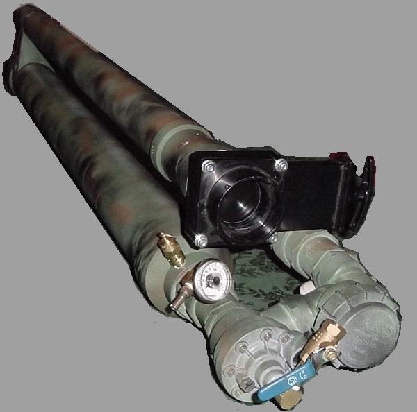

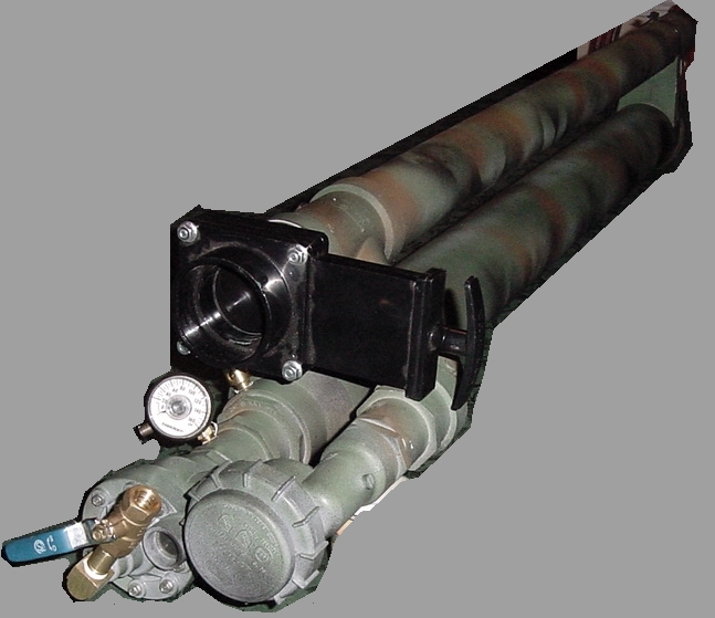

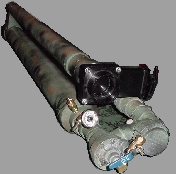

This here is a BreechLoading Pneumatic Cannon.
It was designed specifically for launching Pocket Vortex Nerfs from an enclosed/confined Paintball Tank.
All of the filling and firing controls and Nerf loading had to be close by and accessible , easy to use.
(for those who live in caves and under rock, the Pocket Vortex Nerf is the approved round for eliminating (killing) a Paintball Tank during a game).
Irritrol 1" valve, with Flow Control. Using the valves "with Flow Control" allows you to pull out the flow adjuster guts and tap for 1/4npt threads, real easily.
100psi pop-safety valve. 160psi gauge.
Valterra 2" Gate Valve for the breech.
It eventually got a nice pistol grip blowgun trigger (not pictured).
Can be used with compressed air or Co2.
Air Chamber was 3" PVC @ approx. 4 feet long.
2 inch Bore, about 4.5 feet long.
At 60 psi it would chrono a foam Pocket nerf at about 280fps.
(Most fields limit the Nerfs to 250fps or lower, for safety).
(Yes, we have a PB radar chrono)

I added another pic, as you requested.
Sorry for the cut-out look of the pics, but I gotta get the file sizes reduced so they will accepted by the size monster.

looks great what is the breach loading hach back there
looks home made

Valterra 2" Gate Valve for the breech. Made of PVC, so it glues right on.
They use these for the waste holding tanks on RVs.
(Dump valves).
This one has O-ring seals and is rated for 50psi, max.
But since it isn't on the pressurized side, no biggie, even if it leaked, a little, it would only be for the duration of the shot.
The best thing is that the breech valve seals are replaceable.
I have to say, I've never seen it used this way before, so,
for now, I'll claim it as my original idea.
