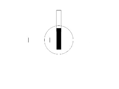

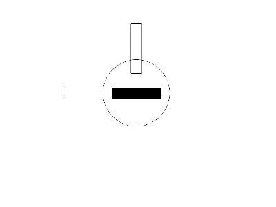

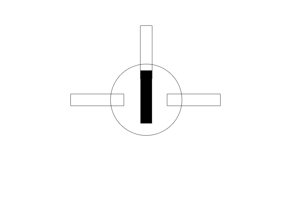

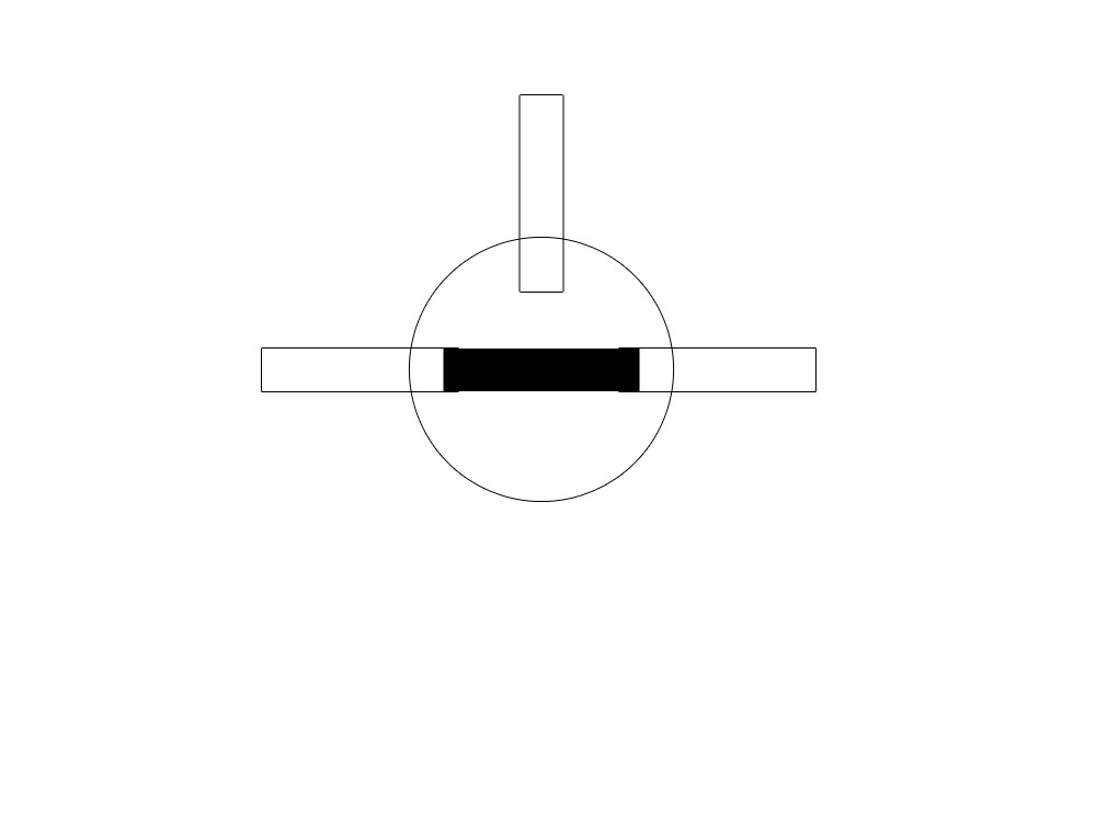

I was hoping of making a sniper rifle where the ball valve also acts as the main loading port (is that the correct term?) anyways, i was looking at some diagrams on wikipedia and it seems that they dont make any valves where, when they are closed, they are shut off to all air flow except for the top "loading port". I was wondering if there was any valve that worked like this.
yea, lots of people have done it, just drill a hole in the side of the ball valve. have fun doing that with a metal ball valve however..can you say cutting oil?

It's doable
I used a Apollo 3w ball v with a l shaped porting .
http://www.conbraco.com/products/products.asp?sub=16.
replaced the ball with one from a regular Apollo ball valve .
