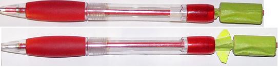

I was thinking today about how to make fin stabilized ammo that would be accurate and cheap, and doesn't need a sabot, and came up with this.
It uses a cheap retractable ball point pen and fins cut from throwing dart fins. Obviously the front would have to be weighted, and spring glued to both parts of the pen. The fins would have to be folded to insert into the barrel or pressed into the pen to put in a magazine. As the dart is accelerated the center part is pushed in which folds the fins in narrower than the bore so that on exit the dart isn't pushed in one direction or another by one fin catching slightly or springing open more.
Is there enough potential inaccuracy generated by having the fins spring open immediately as they leave the barrel, as in the other designs for folding fins, to merit this design?

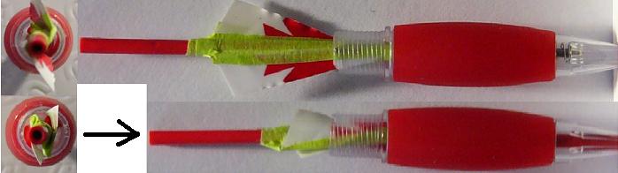

I don't know how I didn't think of this before! If you retain the 'clicking' (is there a term for this?) mechanism, you could retract the fins before inserting, then the acceleration would press the ink part forward and after the body had left the barrel the fins would pop out.
Forgot to add, obviously the air itself wouldn't push the ink part forward, I was thinking of using it in this cannon, where there is a piston in the barrel to do that.
Edit 1: Woohoo! it works. You'll have to forgive my enthusiasm, I had one of those eureka moments :lol:. Attached pic.

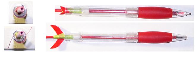

Edit 2: Now it will work in a normal barrel. See 2nd pic.

Hmm...the fins look a little bit floppy. If you're aiming for high velocity, the fins aren't going to do very much.
Have fins which curl up against the sides of the wall so you get some spin-Fin directions-
And then fire it w/ a sabot.
