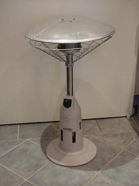

I think you have to keep it simple and use a torch but you might live somewhere where you can get a small heater for outside. then modify it
a one like this I mean but then on electricity
