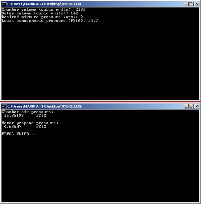

Actually, this is for a set of hybrid fueling formulas I'm working on. The above equation in my post is part of a two-equation system which is used to derive meter pipe and chamber pressures to achieve a good, clean, stoichiometric burn.
There's gonna be a gauge on the chamber and one on the meter. So far I've set up a BASIC program to do all the calculations for me, and rounding the answers to the nearest whole percentage only yields around a 0.1% error in fueling, typically.
BUT, of course, ALL of this methodology hangs on the assumption that my logic outlined in the first post of this thread holds true.
- hybrid_screen.jpg (35.17 KiB) Viewed 2483 times
