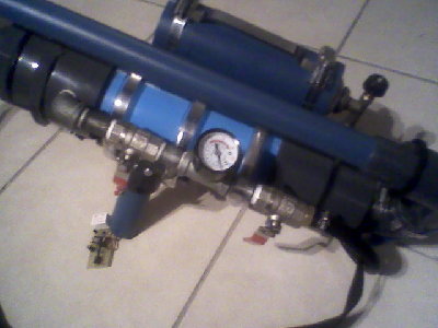

I thought about that too and no its not (I think) I put my PSI guage on the meter and it works like a charm (I got mywhole meter and guage for 10$ in South African R, so I think its alot cheaper this way)

- t_pic_0010_109.jpg (22.83 KiB) Viewed 1916 times
