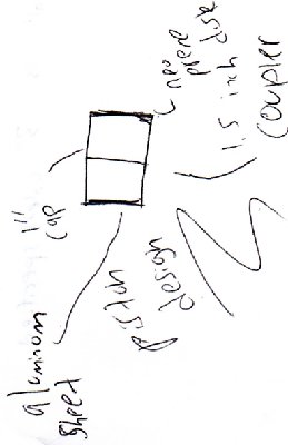

Will this cannon design work?
Will it work? Is their to much room between the barrel and pilot for the piston? I can't get it shorter without the serviceable piston. In real life it is about 1 foot.

Well now...........
1. Wye's are not pressure rated, do not use them.
2. since your drawing is crude, what do you need 4"-3" for and i dont know what you are talking about.
3. You dont need that extra space behind the pilot area (chamber), so use a elbow to make it a over-under.
4. Weight does matter, the lighter the piston the better.
5. Try to find a 3" tee, and a 3" fitting piston, it will be easier.
6. It shouldnt take more than 5psi to seal a good piston.
7. It it could work, disregarding the serious explosive hazards that can serverly hurt you.
Better, cleaner picture needed, and modified with what i have told you.

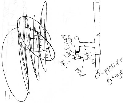

The "Y" is concerning me as well
are you using pressure rated pipe? can you identify pressure rated pipe?
Alright I will. Since I want to get an aluminum piston I'm sure I can get it to fit.LikimysCrotchus5 wrote:Well now...........

What pilot valve are you using?
With a ballvalve and a quick connect you shouldnt need that "Y"
Edit: Oh, and may I suggest using PVC rather than Wye...

A wye is PVC.XxtriviumxX wrote:Edit: Oh, and may I suggest using PVC rather than Wye...
Please make sure you know what you are talking about before passing information along, it's dangerous.
@The OP,
Read this so you know how to indetify the correct type of PVC to use (pressure rated):
http://www.spudfiles.com/spud_wiki/inde ... _Rated_PVC

How do I fit a ballvalve on an endcap? Is a quick disconnect a tire stem?XxtriviumxX wrote:What pilot valve are you using?
With a ballvalve and a quick disconect you shouldnt need that "Y"![]()
Well you can use a 1/4 inch metal ball valve if you make a hole in the cap and tap it.jonnyboy wrote:How do I fit a ballvalve on an endcap? Is a quick disconnect a tire stem?XxtriviumxX wrote:What pilot valve are you using?
Quick connect
Tire stem valve

How and what is a "tap". So you would get the quick connect in the endcap then hook up the hose from the compressor. Then what would the ball valve hook up to?LikimysCrotchus5 wrote:Well you can use a 1/4 inch metal ball valve if you make a hole in the cap and tap it.jonnyboy wrote:How do I fit a ballvalve on an endcap? Is a quick disconnect a tire stem?XxtriviumxX wrote:What pilot valve are you using?
I think its about time you do some more searching.
