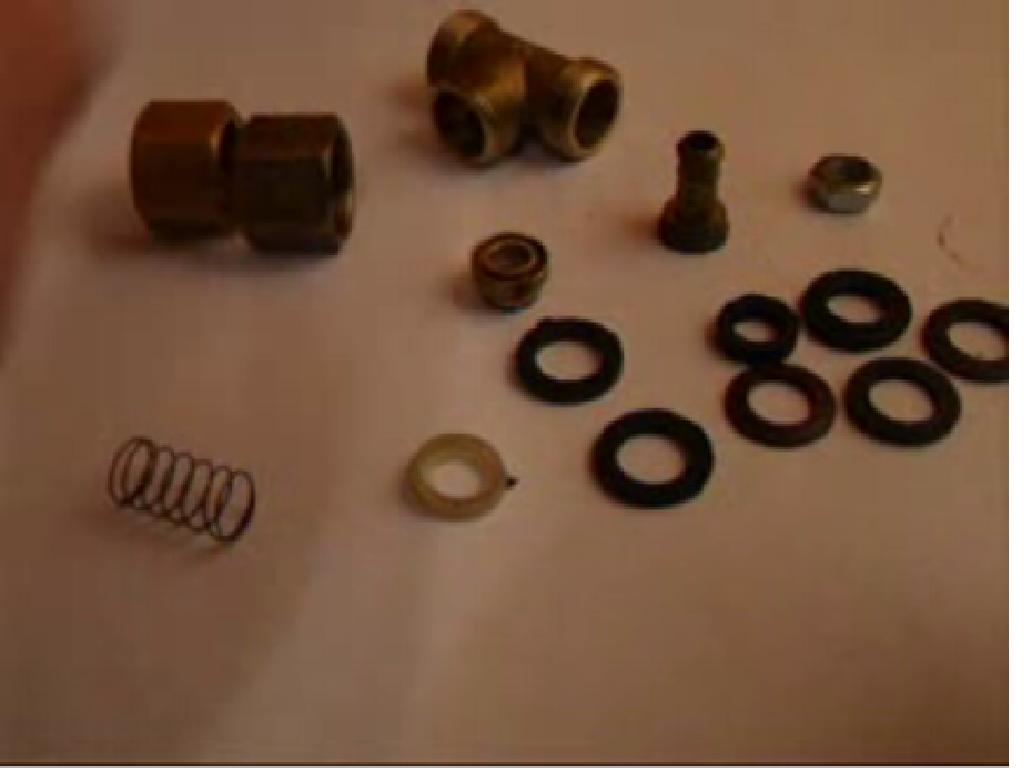

Did you do the pressure testing your self? Well if you did its a nice refrence. Thanks alot but Im still wondering on which valve i should use. I cant order valves off of mcmaster because my parents dont like online ordering. But if i made one then its perfectly okay. That homemade QEV video up there ^^^ didnt help me much cuz its in french.
EDIT: Well This is the best that I could do, If somebody can tell me all the parts below, I will give them a virtual hug.
