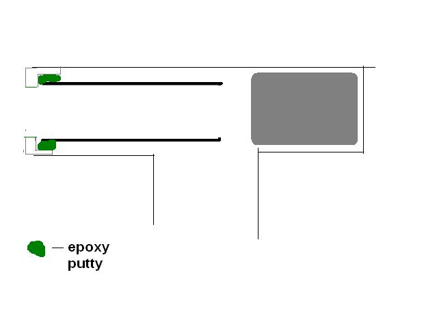

I am working on a piston valve shotgun. for the pipe that the piston seals against, I epoxied it into the back of a bushing. do you think the epoxy putty will be able to keep it from sliding out with 300psi of pressure?

Perhaps a sketch of how it is put together that shows how it is epoxied would help us.

here is a pic

I don't see any problems, the epoxy is pretty much only a sealant for that application. You should be fine, just as long a the bushing stays in place.

Considering that there's essentially no force trying to push the pipe out, and (by the looks of it) over 1/2" of steel opposing whatever force there is, yes, I think the epoxy should be fine. I've had JBweld survive several thousand psi in sparkplug type applications exposed to a lot more violence than this will be.

DYI wrote:Considering that there's essentially no force trying to push the pipe out, and (by the looks of it) over 1/2" of steel opposing whatever force there is, yes, I think the epoxy should be fine. I've had JBweld survive several thousand psi in sparkplug type applications exposed to a lot more violence than this will be.
wouldnt there be a little less than 300 pounds trying to push it out assuming it has a 1" seat?

the seat is 3/4" and that isn't a 1/2" of steel holding it in those are the threads.
Exactly. As I said before, hardly any force. If it was a 1" seat, there'd actually be 236lbf on it at 300 psi.
