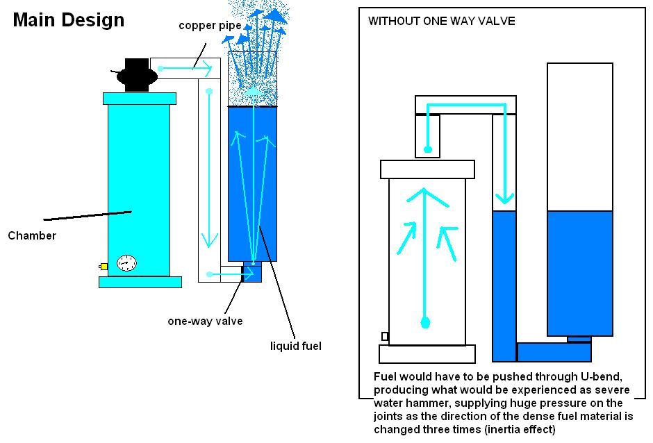

I am going to assume you are just being cautious, but want to know in depth how the thunderpipe works. So ill try to tell you from how i think it works.
Firstly understand that the internet is about the sharing of information, and that any assumed information about how the thunderpipe works is not subject to censorship because we are only assuming how he made the gun, not reciting stolen plans or a reverse engineered copy.
So no matter what anyone says, you can freely converse about any piece of technology and how it works. Remember that Spudtech makes money out of potato guns, but does not control the exchange of information about them.
Anyways on with the show!
THE GLORIFIED FLAMETHROWER AKA "THUNDERPIPE"
Its quite simple how the device works, looking at its structure you can see that the device is constructed to be used as a special FX prop, because its size is at a minimum. However this also serves another purpose.
The copper barrel is filled with a flammable liquid, such as diesel or meths, whatever that doesnt matter, at the bottom of the chamber there would be a simple one way valve, to prevent the liquid to be fired from self-leveling inside the smaller air valve to the left of the barrel, as this would create interial problems, possibly structural problems if the air had to push the liquid through a U bend.
the high pressure air is dumped from the chamber and travels to the bottom of the barrel where it rapidly expells the liquid with enough force to push most of it past the passive lighter device at the top of the barrel.
This device may be electrically operated, as having a lit flame above a large tube of vapour giving, flammable material seems perilous to say the least.
As the liquid is pushed past some of it will combust, which as any chemist would know expells chemical energy which self sustains the reaction throughout the rest of the moving spray of liqiud above it, creating the awesome fireball effect.
Ive attached some pictures to help you understand, this thing would be a breeze to make but you would want to stand a fair way back when beta testing it!

The thunderpipe is essentialy a pneumatic with an electric (un modded) sprinkler valve, and a bent, copper barrel. It may or may not have a no-return valve.
Now, how that particular client did the fireball, I'm not entirely certain. Meh, if you can't figure out to do it, you shouldn't be playing with fire anyways.

I understand how the Thunderpipe works it is fairly a straight forward design. I also have some ideas on how to create the fire ball effect, safely. And that is my question how exactly did they make the fire ball, I don't see an external ignition source?

anyways, yeh i would think it is electric ignition, or some sort of flame producing ignitor that is electrically operated at the same time as the solenoid is opened.
if it was like a zippo above the barrel chances are the fuel would detonate inside the barrel.
