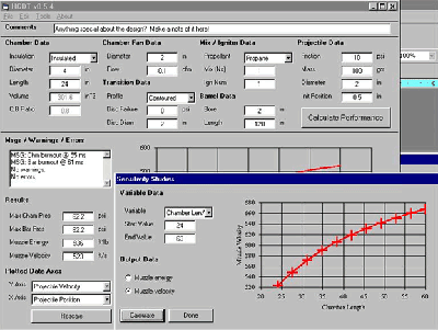

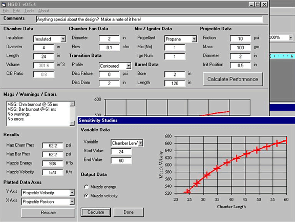

Yes, and the 0.76 CB gun will probably have a lower muzzle velocity than the 1.9 CB gun, if the spud survives. HGDT says (guessed at some things about the gun) the 1.9 CB gun will have a muzzle velocity of 670 FPS, the 0.76 CB gun 520 FPS.bigbob12345 wrote:...
which gives a ratio of 1.9:1, not excactly ideal
but shorten that chamber two 2ft and look what happens.
3.996*24(in)=95.904*3.14=301.138ci
And it comes out with a ratio of 0.76:1, ideal
If you want to increase the performance of the gun it needs a longer barrel. Making the chamber smaller will decrease performance.
