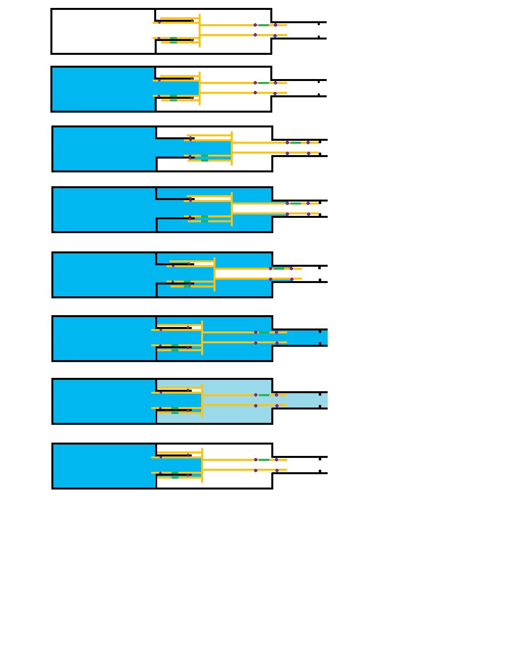

I did have an idea floating around in my head where you have a piston that rides on a piece of pipe, the pipe leads to the chamber. Anyway the pressure pushes the piston forward on the piece of pipe and the piston seals the barrel. Air then leaks out of an equalization hole in the piston and fills up the 'secondary chamber'. If the secondary chamber was say 1" pipe, then the piston would be about 3/4" and ride on 15mm pipe.
So the secondary chamber would be the room between the piston and the 1" pipe, lenght wise it would extend from the piston to the barrel. So it could be any length.
Anyway, once this secondary chamber fills up, there would be more surface area pushing the piston back (it'd be made so it would) then forward, accompanied by a spring the piston would be pushed back and open up the barrel port.
I have no idea whether it would work or not, just an idea floating around. I guess it would cycle like full-auto. You could even put a rod on the front of the piston and use it to help with feeding in the barrel with a hopper.
This diagram isn't exactly the same idea, but is similar and may help you understand what the hell i'm talking about.
- Has thanked: 581 times
Interesting in theory and it would probably work in practice, I probably would avoid it though due to potential alignment issues and the need for perfectly sealed parts, I try to avoid using o-rings as much as possible - but that's a personal view.
