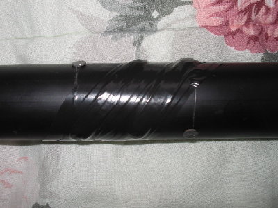

Hello I am making a combustion spray and pray olny a small one and I am putting in three spark gaps and I am hoping that the piezo will jump all of the gaps. The gaps are about 8mm across I am wondering about the normal kw a bbq piezo puts out and if it can jump 3 8mm gaps or olny one.
And yes the gaps are wired correctly.

You can easily jump 3 gaps but you'll want to shorten each gap down to 1/8" of an inch or so. Place them relatively evenly down the center of the chamber for optimum performance.

Why not? Btw I was wondering if the piezo could jump the gaps I have or will I have to test it?

It will not jump them if it is an ordinary piezo.

3 - 8mm gaps will be very challenging for a piezo. Like I stated before you can pull it off if you shorten your gaps.

In my spray and pray with a BBQ igniter powering 3 sparks I get consistent results with .050" to .060" each. Metric I assume would be 1.2 mm to 1.5 mm each. Good luck!

3 8mm gaps are the same as one 24mm gap. If the ignitor can jump that, it will work.
Try to make the gaps like 2mm, then it will certainly work.
Oh ant btw, I dont know how long that chamber is going to be, but your gaps should be evenly spaced at 1/4th, 1/2 and 3/4th of the chamber length for optimal performance.
Placing all 3 spark gaps near to each other in the middle wont improve performance alot, and then even two gaps spaced at 1/3 and 2/3 would already be better.

psycix wrote:Oh ant btw, I dont know how long that chamber is going to be, but your gaps should be evenly spaced at 1/4th, 1/2 and 3/4th of the chamber length for optimal performance.
(1/6)L, (1/3+1/6)L, (2/3+1/6)L, simplifying gives (1/6)L, (1/2)L, (5/6)L, might be a bit better for three spark gaps. L= chamber length and the distances are all measured from on end of the chamber. For a 12"L chamber and three gaps you would put the gaps at 2", 6", 10".
In general, the first gap is at (chamber L)/(#sparks)/2 from the end of the chamber. Subsequent sparks are at (chamber L)/(#sparks) from the preceeding spark.
This gives the optimal spacing for a closed chamber. Nobody really knows what the optimal spacing is in a gun. The difference in performance between my gap spacing and psycix's is probably unmeasurable.
For a generic piezo BBQ igniter I would try to keep the total spark gap to 1/4" (6mm) or less.

You're right jimmy, 1/6th, 1/2 6/5th is what I meant :P
My brain is getting old already and I'm only 19! :shock:
That way you will create 3 DOUBLE flamefronts, for a total of 6 flamefronts, each burning off exactly 1/6th of the chamber.
Now an inch forth or back wont make much difference but the point however, is that the gaps should be spaced out over the chamber, and not stick together at one point, since that will be near useless.
Yep, 2mm per gap it would be.
