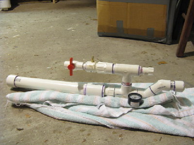

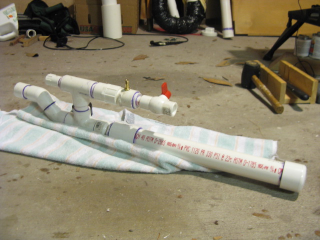

Ok, i have just completed this piston gun, it's a 1" barrel sealing piston with a 1/2" port and a 1/2" pilot, all the parts are pressure rated, I used extra-strength PVC cement, and all the bushings are in all the way. Anyway, my main question was- What would be a safe/reasonable max psi for this? I was thinking between 80 and 120.
Also- what are some ways to make a piston seal better? mine leaks a tiny bit
Need answer ASAP

I try to never go over 120psi with my stuff unless I am trying to blow something up.
You should experiment. Depending on your design you may find a lower pressure that will perform about as good as full pressure and be safer.
Is your piston leaking around the face or the side?
I second what frank said... Nice build by the way.

neoprene rubber,? there are alot of kinds of sealing faces bike innertube is realy cheap but not always the best

It may seem it's leaking from the sealing face when it could be the bolt/washer. If you have a bolt and washer, epoxy it up and if the leaks continue try cleaning your sealing face, sand down the barrel seat (port) to make sure it's even and possibly try a different material.
Nice build btw, reminds me of my V.A.L except with a backward chamber and half the stock.
Is the barrel cut flush? If it is leaking slightly, it could be just off a little. Try adding some soft material, such as cloth, between the seal face and piston.
Yeah I've had even the slightest imperfection on the barrel end result in a so-so seal.

Some grease on the end of the barrel might help a tad.
