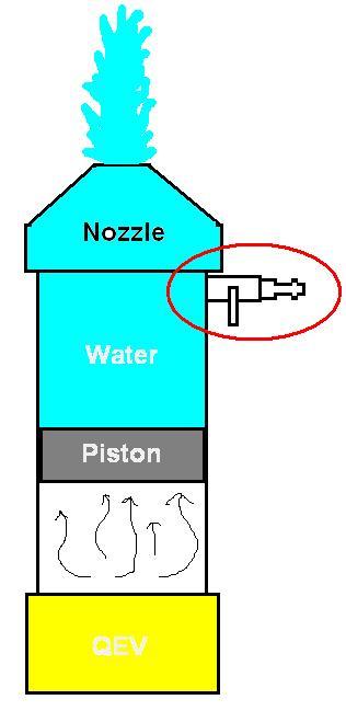

this is what I think you could do for re-setting the piston.
just put a quick connect nipple with a ball valve (circled in red) at the end of the piston assembly near the nozzle.
and as far as the guide rod rusting, you shouldn't have any worries if you give it a good coat (or 8 ) of varnish/polyurethane before you assemble the gun (it acts as a water-proofing agent).
hope i helped.
hope i helped.

Good ideas, but Poland Spud- what is the "regular way" and Sthorne- Good idea but why would you need the quick connect?

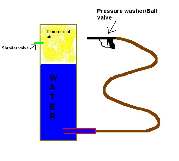

Just use a tank on top and a blowgun as your trigger.Use sufficient pressure and you will beat a store bought soaker hands down...

a traditional design looks like this ->>> (pic)
[sorry for the quality of my drawing]
- soaker.jpg (30.48 KiB) Viewed 3474 times

psycix wrote:1-A BV.
2-Why do you want to use a guide rod?
1- Sounds good
2- Thought it would be neccisarry since i want a kinda light piston thats going to be pushing a lot of WATER (

If you want to make a water gun with a piston to separate the air and water, follow this setup: http://www.sscentral.org/homemade/supercannon2.html
No guide rod is needed. The piston stays aligned because it consists of two piston cups.
To return the piston to its original position I used a simple ram rod. You'll need a valve to shut off the air supply and vent the chamber behind the piston but aside from that it's straightforward.
I would not suggest something like QEV. That'd be excessive and too expensive for a water gun. A simple ball valve in front of the nozzle is best. Opening times matter significantly less because the shot has duration. Ball valves impeded flow the least and do not make the flow more turbulence (or make it minimally more turbulent). You also won't have to worry about water dribbling out if the angle is too low with a valve in front of the nozzle.
