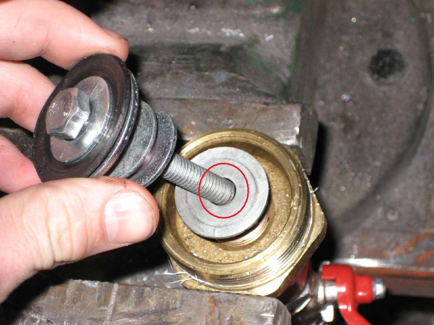

SpudFarm
Posts: 2571
look, i don't feel like writing a whole lot right now but if you ask i am sure i or someone else answers
that is how it looks like done
diagram
diagram
piston diagram.jpg (3.16 KiB) Viewed 3369 times
