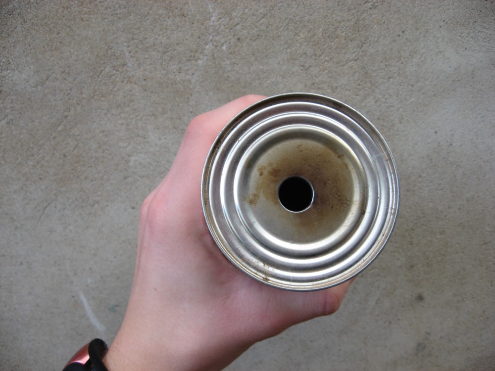

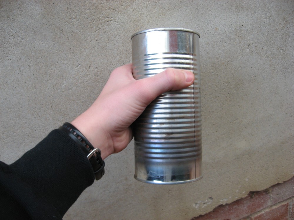

I have seen many videos on youtube of the 'jam-jar pulsejet', and after trying it myself, I decided to try making one that would last a bit longer.
The best result so far has been from a tin can I drilled a hole into. It runs, but after about 10 seconds it goes out. Not exactly sure why, as plenty of fuel is left, but I suspect the immense heat generated causes way too much fuel to vapourise, making it too rich to run. It is a pain to light, as I have to get LOTS of fresh air in with a small pump with a hose attached, light, and hope for the best. Somtimes it works, somtimes it doesn't.
If any of you have a little free time, try making one out of whatever you can find. If it lights, goes brrrp then stops, the hole is a tiny bit too small. If it just goes whoosh, it is probably too big. See if you can make one run longer than mine... then tell me how you did it lol.
Later tonight I might make another vid so you can see the flames shoot out of it.

I never really intended this to power anything, so thrust really isn't that much of an issue. (although if I manage to get any thrust from one reliably I might mount it to a small car or boat) Also, these seem very depended on how much fuel vapourises. I have yet to make one run on it's side, probably due to the higher surface area the fuel has. Perhaps a 45* angle would be a good compromise????
Anyway, I made another out of an identical tin, but with a slightly smaller hole. It is louder and goes out quicker. I decided to try running it in some water to cool the fuel a bit, so I sat it in a bowl with a few cm of cold water in it (any more and it will float). It was fantastic. Although it didn't quite manage to burn all the fuel, it easily burned for 3 or 4 times as long as the one in the vid, and the bottom half of the tin glowed a dull red.
I am using Methylated spirits as fuel. I think it is also known as denatured alcohol outside of Australia.
