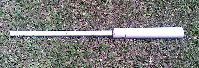

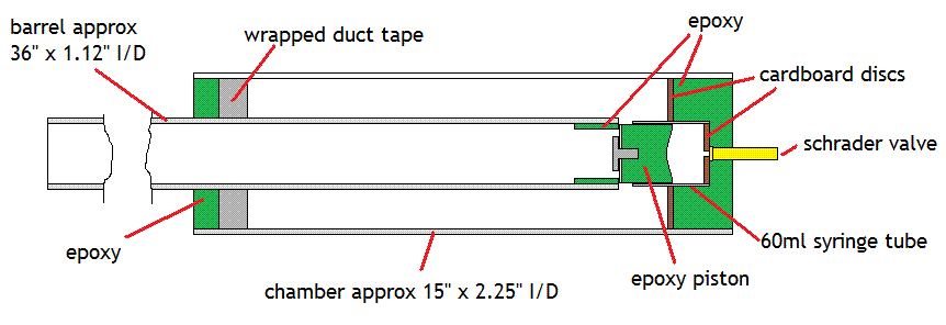

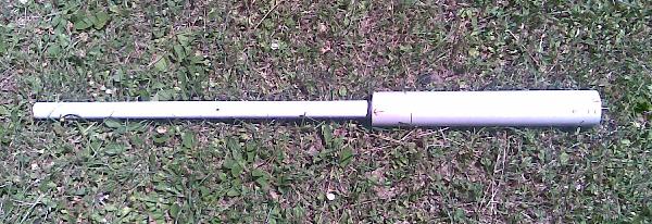

following my brief stint at home, I returned to Spain with a few hundred mL of epoxy in my suitcase. Add that to some PVC piping from the kind guys in the Maintenance department, a syringe scrounged from the lab and an old inner tube from the garage and there you go, the biggest coaxial I've ever made. It feels a little primitive compared to my other efforts, given limited facilities I had to build it, far far away from my workshop.
How does it shoot, you may ask? Well, I don't know if it does yet as the last pouring of epoxy still has to cure. My concern is that the piston diameter is very close to the barrel diameter, so sealing might be an issue if the alignment isn't close to perfect. As always with epoxy, it's a matter of wait and see! I'll let you know in a few hours.
Meanwhile, have a photo and a diagram:
internal diagram
internal diagram

edit: aaaargh! Well it seals perfectly well, but as to firing, just exhausts everything through the schrader. Diagnosis: too little difference between piston and barrel diameter, it should have been an obvious design flaw from the start but I was perhaps a little too enthusiastic to get building :?
Ah well, back to the drawing board.

I hope for you that this thing works. The piston is unserviceable (unless you want to waste epoxy) and has almost no frontal area...
We already had the discussion about such low frontal areas some time ago where you expected a thin layer of air to push the piston, and you'd better be right. If not, you are screwed :P

Wait is the porting about the same size as the piston?
To me, it looks like the barrel is smaller but if you trying to seal something with the same diameter as the piston, you know that wont work :wink:
O, ic that im a little late :lol:
But its ok, just salvage the piston, have a smaller porting, and there you go! :)

nice try, but it is missing some more volume, or gap in between the piston and compression tank. how bout shaving down the epoxy?

I'm still right ;p The issue here is the difference between the piston diameter and the diameter of the barrel porting. The area over which that thin layer of air has to push on makes a big difference, especially with a poor pilot like a schrader.

jackssmirkingrevenge wrote: I'm still right ;p The issue here is the difference between the piston diameter and the diameter of the barrel porting. The area over which that thin layer of air has to push on makes a big difference, especially with a poor pilot like a schrader.
I think it's the schrader. Chuck on a ball valve and you'll be fine IMO.
I've got quite a tight tolerance on my piston where you can only just see the gasket around the barrel when it's sealed.
If you can get that initial pressure difference to happen a lot faster, the piston should come unseated enough for the air to get in the gaps between it and the seat and push it back.
