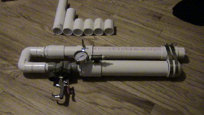

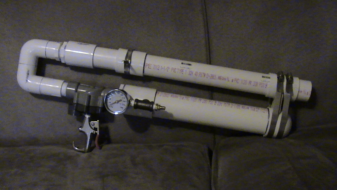

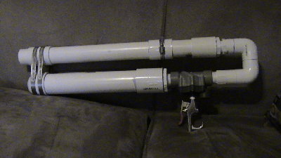

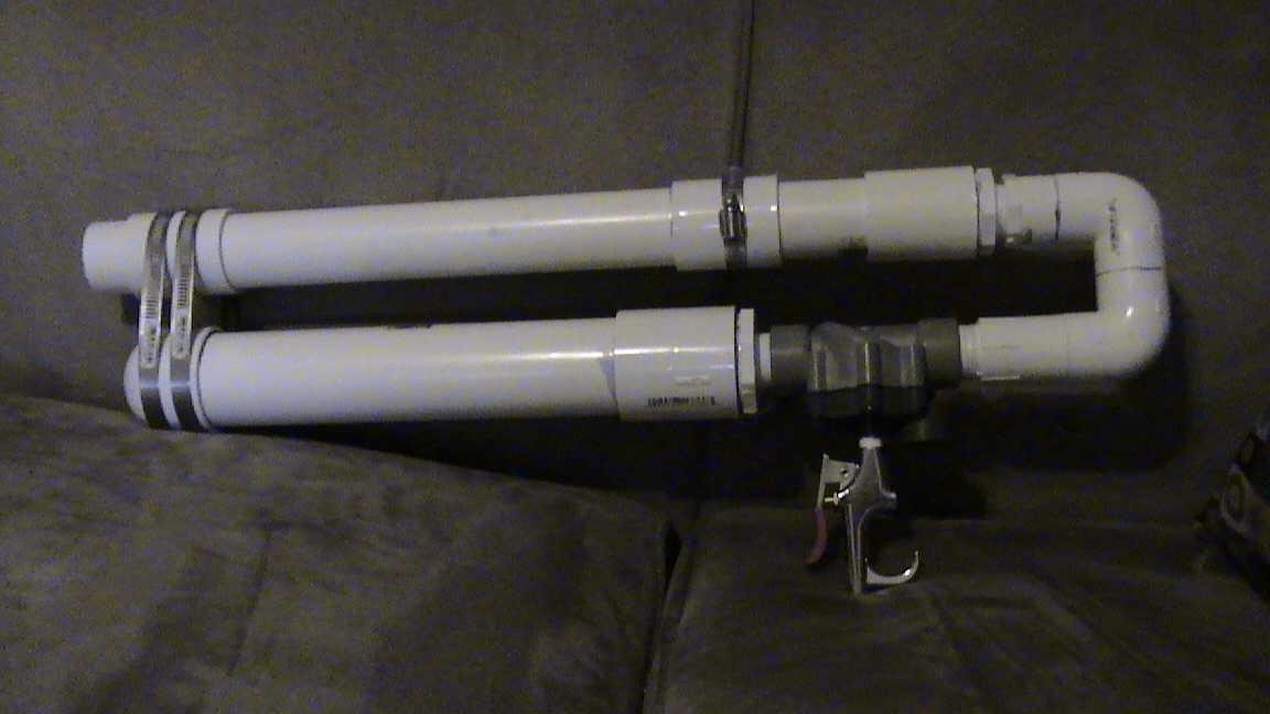

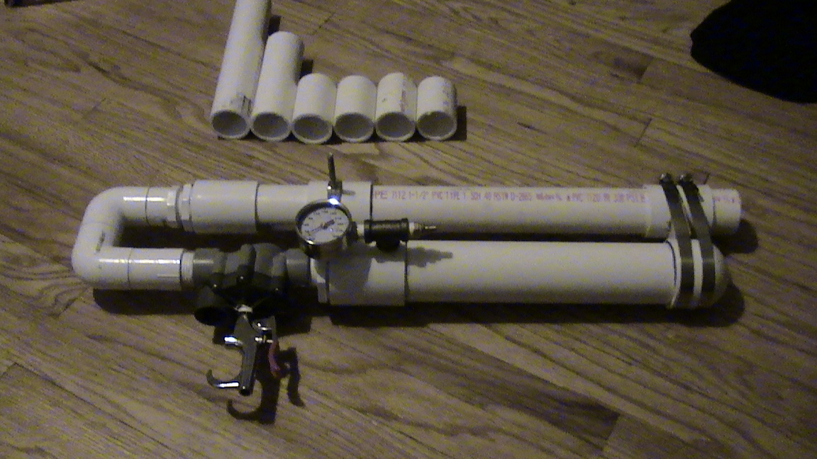

I made this little gun about a month ago, just haven't gotten around to posting it. I use it to shoot paintballs and airsoft pellets and whatever else i can fit into it.
There's not a lot new going on here with this gun.
2 inch diameter chamber and 1.5 inch barrel.
1 inch modified irritol sprinkler valve.
It uses cartridges made from 1.5'' pvc which fit in between two couplers. The breach is held together by friction. It usually doesn't open unless i'm using very heavy ammo, or the pressure goes above 100 psi.
My only problem with this little guy is i need to make a better barrel support, other than that it's a fun little plinker.
The gun and some of the shells
the other side of the gun
FishBoy
Posts: 575
nice, i like it. I must be fun using that in airsoft.
btw, are 3/4" sprinkler vlaves as easy to mod as 1" ones?
VH_man
Staff Sergeant 4
Staff Sergeant 4
Posts: 1827
Location: New Hampshire
yes, they are the same size internally, they just have different threads.........
blind909
Posts: 828
Location: Las Vegas, NV
Nice, You should paint it though, and add a foregrip.
@FishBoy, yes, they are just as easy, And in fact, the 3/4 inch and 1 inch valve tops are the same size, you could use a 3/4 inch valve top on a 1 inch one.
EDIT- VH_MAN BEAT ME TOO IT.
