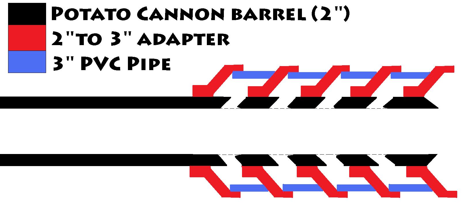

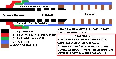

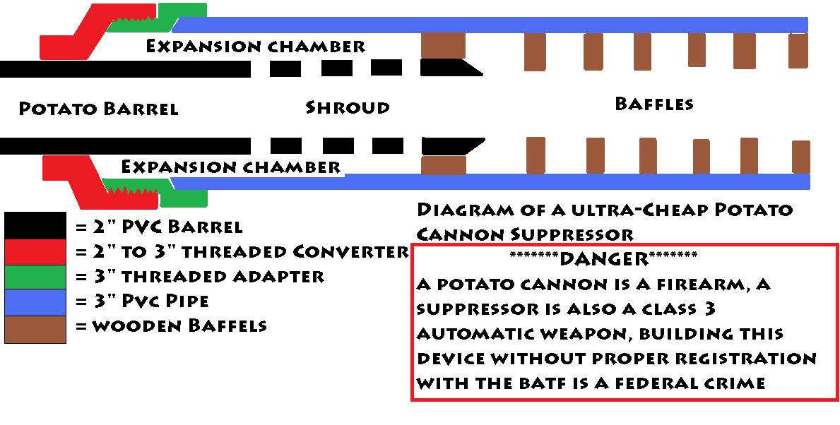

Here is a side cut-away picture of the first one i built...

I actually would like one so I don't disturb my neighbors. Since the last mod my launcher is a real wailer. I'm surprised you even need the wooden baffles. In a suppessor for a firearm the wood is there to slow down the bullet to subsonic speeds(below 770 mph, or 1129 ft/s) to eliminate the bullet from causing its own sonic boom. Did you pack the space between the expansion chamber and barrel with steel wool? Please post a video.
um, i use subsonic ammo for my firearm, and my firearm baffles are make of steel, not wood... i would be careful filling the expansion chamber with steel/wool (steel wool can burn under the right conditions) however after burning; the steel wool will likely still help suppress the sound; I do not know if my steel wool has caught on fire yet, if you look at the wool closely; a blue-ish tint will indicate that the wool has burnt.
To answer your question; yeah, there is steel wool in the expansion chamber of my new suppressor. its just easier to leave it out becasue you have to re-pack it every time you load a new potato.
and secondly; i feel the baffles does reduce the sound moreso because they trap some of the sound that does not make it through the holes in the barrel (holes leading to the expanison chamber) but, if you feel that the need of baffles is not imperative; please let me know your results upon completion and testing
good luck!
The massive quantity of cold air from a spudgun as opposed to a fairly small volume of hot gas from a firearm mean that you need a colossal suppressor to muffle the cannon blast.
I had a go at it before, best I got was a loud thump instead of a loud bang, it changes the sound but I think there's too much gas being dumped for a reasonable size suppressor to seriously quieten your average spudgun.
