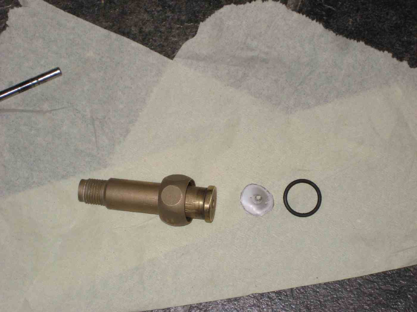

I hope that this inspire you but I made homemade "union" just from a few parts for my hybrid cannon and for free.

look, it clamp's the disk against a steel nipple. i will get one machined out of a 2" steel bar.
i will make something like that i think

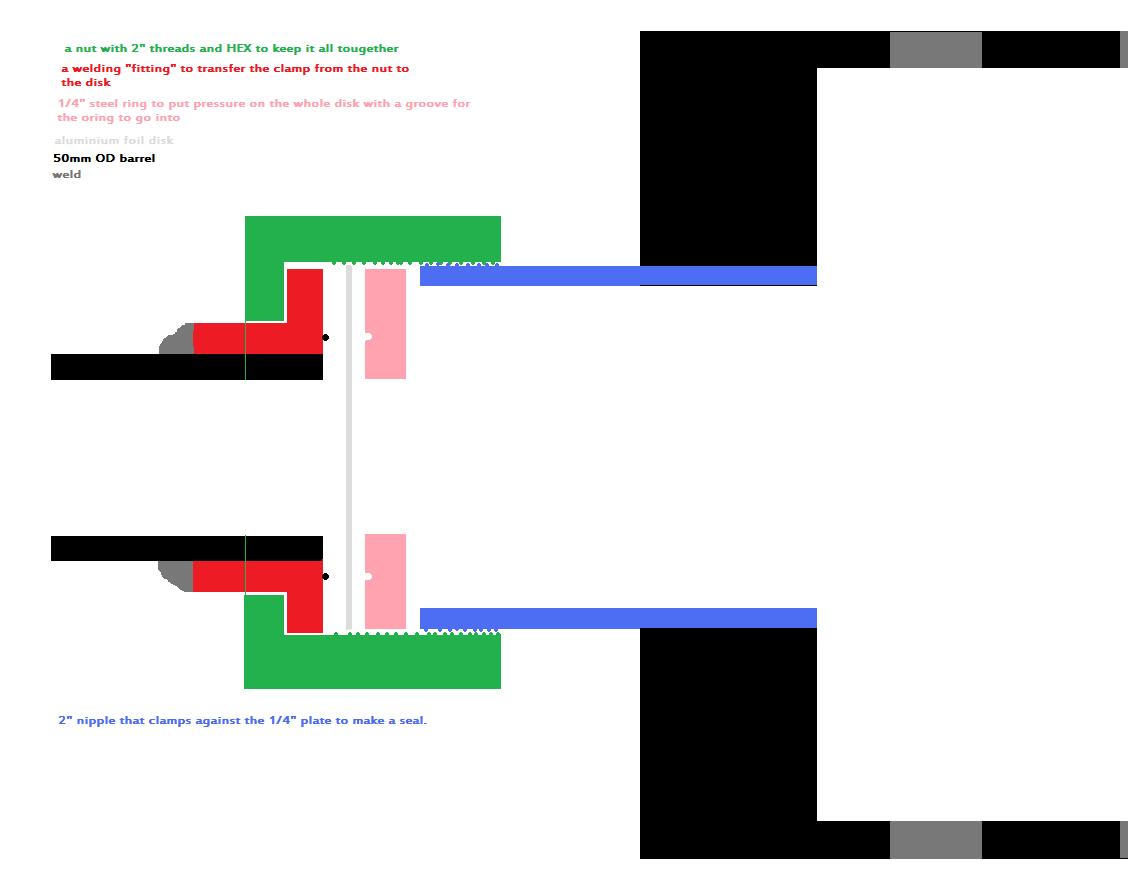

i made a diagram over my burst disk holder. hoping for larda to get on with me on this one :D

I don't think that there will be a need to have an Oring in there, or if you do have an Oring..I don't think that you will need the groove cut in the steel ring because this will probably rip the disc if it were foil and do nothing for it if it was sheet aluminium.

i am ashemed of myself.. i drew the oring on the wrong side :oops:
_fnord: i wil not ever make any flow restiriction on this gun :P
MAX: if the groove does destroy the disk i will just make a new plate, and when i think of it, the "cam lock" on my barrel sealed perfect so i will have a look at it and make the internals like that.
i would be happy if you guys could talk metric if you can..

BTW, the holder design look pretty solid...basically a homemade union.

yepp it is like a homemade union, but i am stil looking into more designs that will be easier to make
