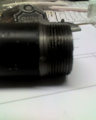

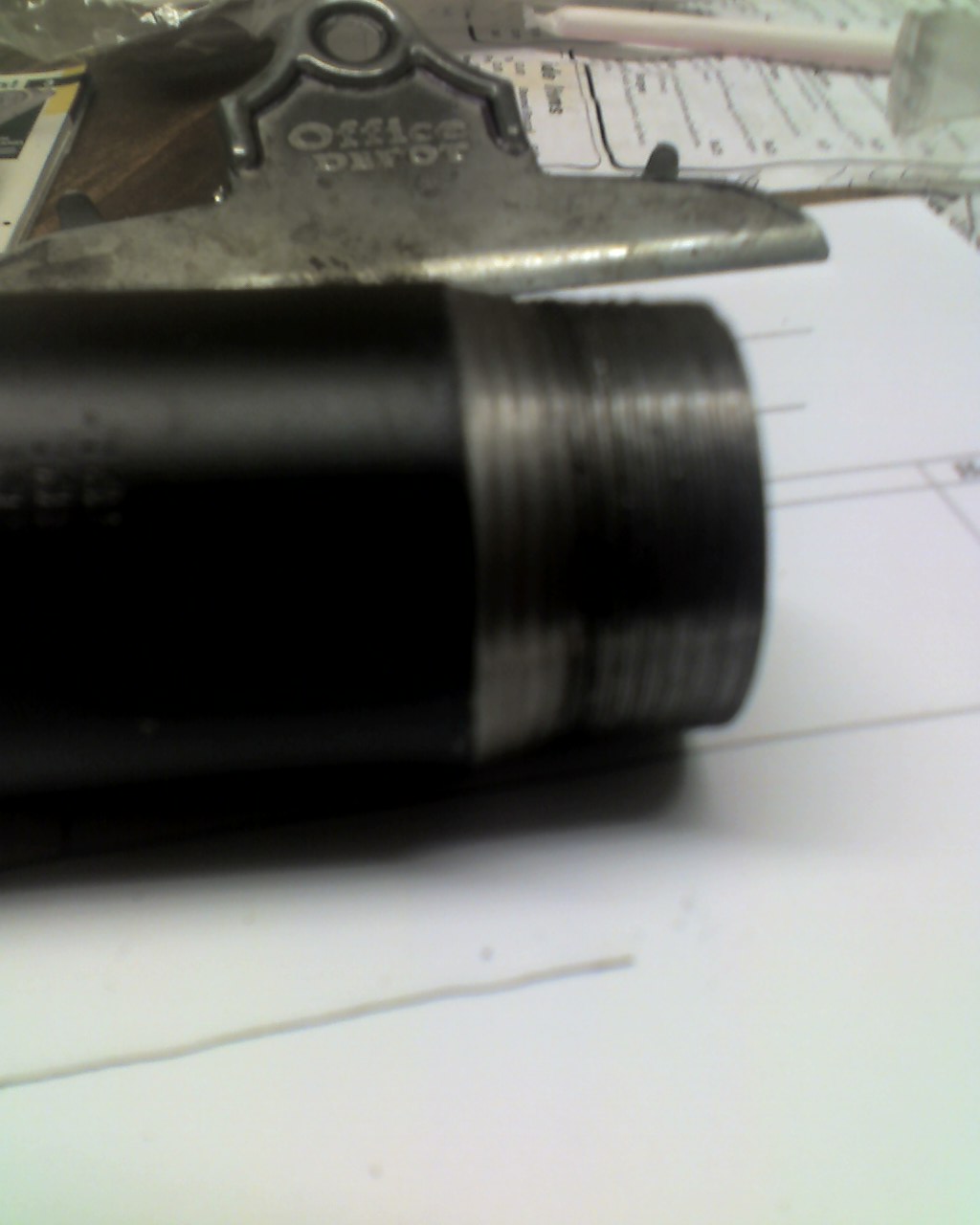

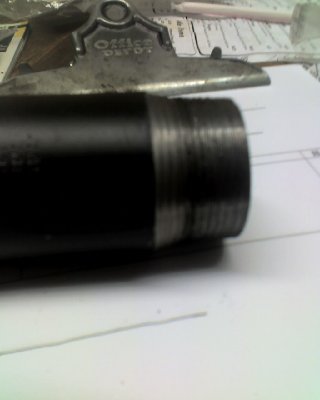

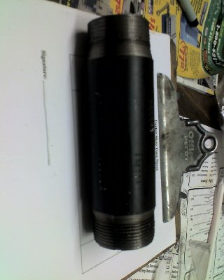

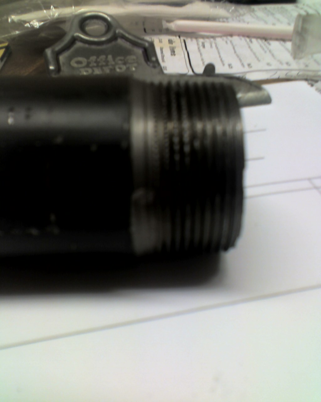

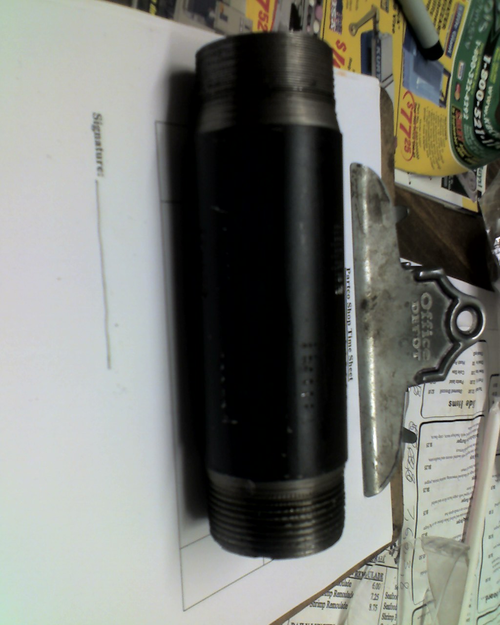

I went to the local Home Depot yesterday for a rush job at work to pick up a 6" long 1.5" black iron pipe nipple. I figured this would be fairly simple: if they don't stock it, they can cut it. Sure enough it wasn't stocked, so I asked an employee to cut one for me. All seemed well, he chucked the pipe up and began cutting, so I went and browsed the brass fittings to kill time. A few minutes later, he came up to me with the nipple wrapped up in some paper towels. I didn't bother to check the threads as I figure any fool could run that die machine, seeing as how its designed to be easy to operate. When I got back to the shop, I climbed up on the compressor and unwrapped the nipple. I hope these pictures do this piece of work justice.

And are there even threads on that one side? It kind of looks discolored like there SHOULD be threads there, but i cant really see any.

My local Home Depot and Lowes guys are fairly decent. I can't imagine any of them turning out something like this. I'm not sure how he even got it to do this...maybe using the 1 1/4" setting or locking it down somewhere between 1 1/4 and 1 1/2.

Did he try and use a barstard file to make those threads?I mean what the hell is that.

As far as how he did this, he used the wrong size dye.

Yup, he used the wrong sized dye as well as tried to cut too short of a length of pipe. Most machines that Lowes and HD use limit out at about 10 inches, then they don't chuck properly and you get that kind of action.

There's a decent chance he damaged the cutting die whipping out this little miracle. I wouldn't necessarily call it a firing offense though. There's a reasonable chance he had never used the thing or been trained to use it.
You do have to question though why some big question marks didn't fly for him when the pipe came out like it did. Take it back and show the manager. Do like Hubb suggested...ask to keep the bad part.
