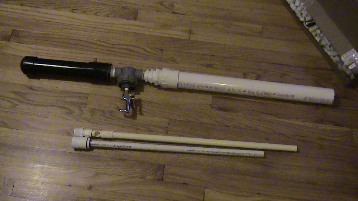

This is just a throw-together gun i made to make use of the new barrels i recently made. It uses a 1 inch irritol sprinkler valve, standard stuff.

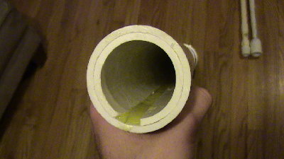

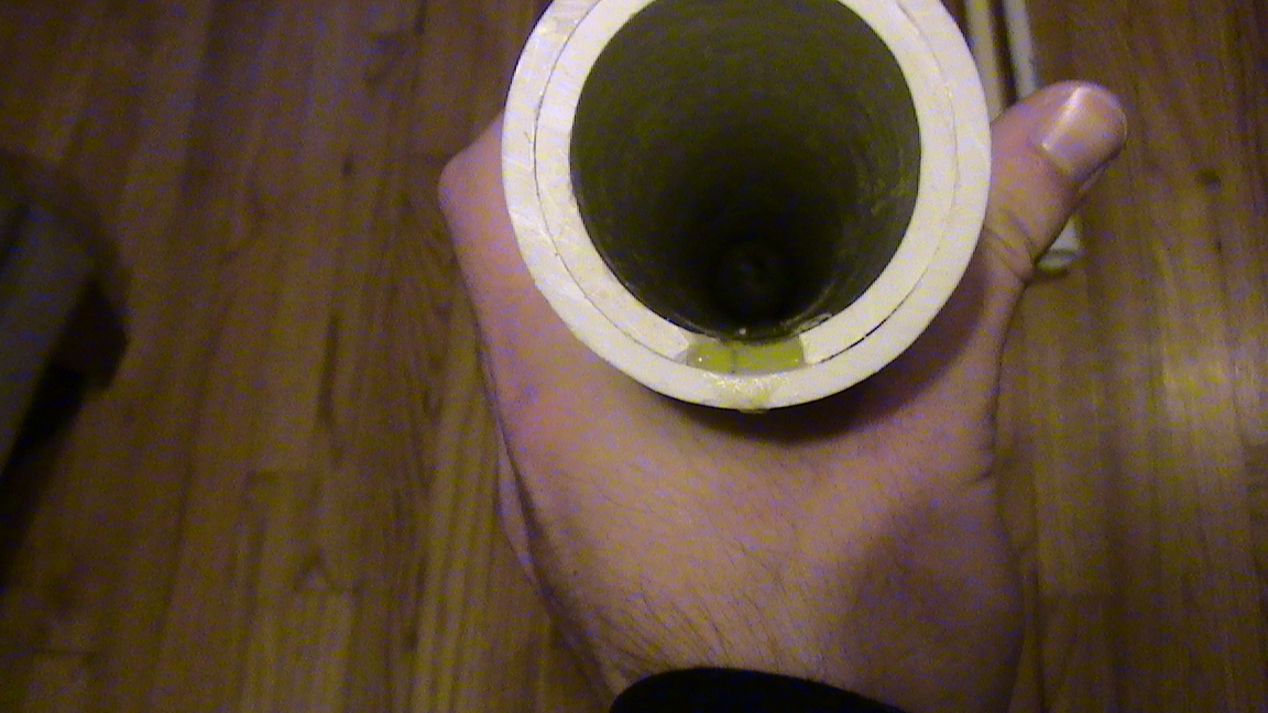

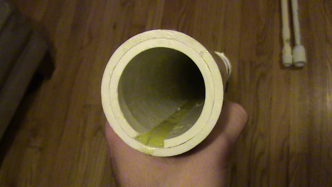

The sleeved golfball barrel was a pain to make, i cut very small slivers out of a piece of 2'' pipe with a table saw, until it just fit into the other 2'' pipe. once i got it in there about five inches, i just pounded the crap out of that thing until it was in there all the way. Unfortunately, i was left with a small gap in the inner barrel. I filled it with low viscosity epoxy and it turned out great!

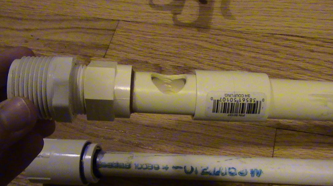

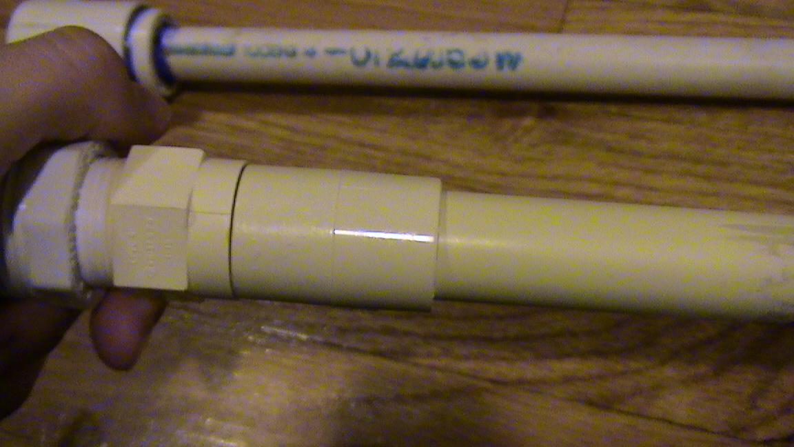

The paintball barrel was much easier, i just drilled out a hole big enough for the paintball to fit through, and i used a bored out coupler for the bolt.
The golfball barrel is my new favorite barrel, it puts golfballs out of sight.
my new plinker gun.

mister pointy wrote:i just pounded the crap out of that thing until it was in there all the way. Unfortunately, i was left with a small gap in the inner barrel.
However, you should consider one of those nice sdr 21 1.5" sleeved in sched 80 barrels. They are much nicer than the slit 2" ones.
Nicely done, though that gap on the GB barrel is the bad point.
You can get a great GB barrel from the spudfiler's shop.
