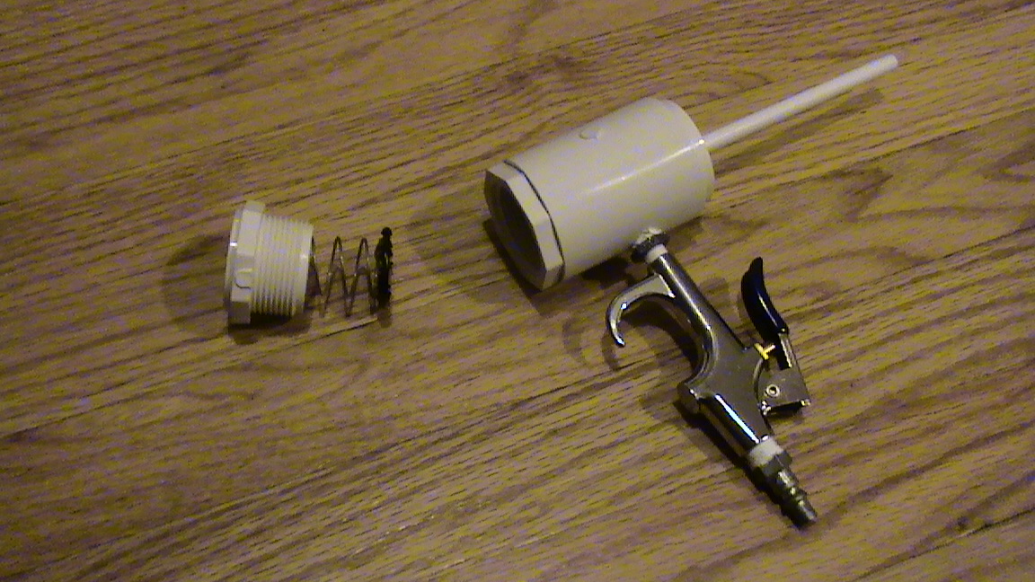

So i decided to make a slightly better model using pvc and pen tube.

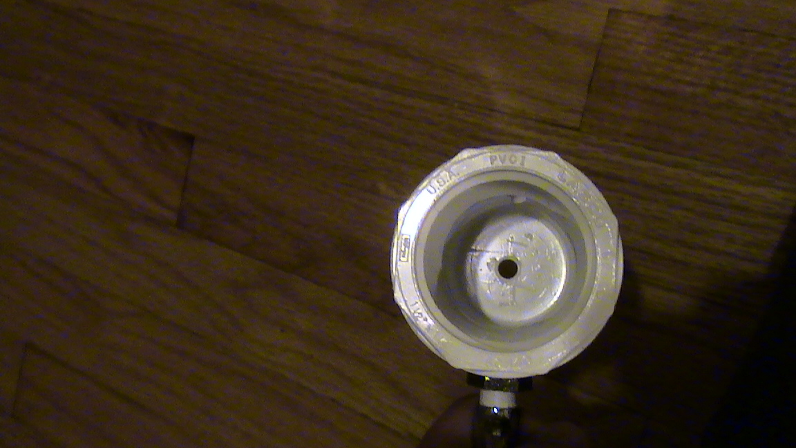

all it is, is just a 1-1/2'' plug, 1-1/2'' coupler, 1-1/2'' to 1-1/4'' reducer bushing, and 1-1/4'' threaded plug.
The pen tube is held in place by friction and the 1-1/4'' threaded plug has a small spring and plunger on it.
Because this thing is so small, it has a small bb capacity, but boy does it shoot fast. It's quite a bit of fun to shoot, so i think i will be making larger scaled up versions sometime soon.

Well what the plunger does in a cloud like it does in a vortex block is that it helps feed the ammo into the barrel.lambey108 wrote:hay mate nice effort
im kinda new to the whole cloud gun thingi understand the basic principles of a cloud gun but i dont understand how and wat the plunger at the back dose
thanks
Like it's hard to shoot the last few rounds, the plunger decreases the volume in the chamber making it easier to fire the final shots.
