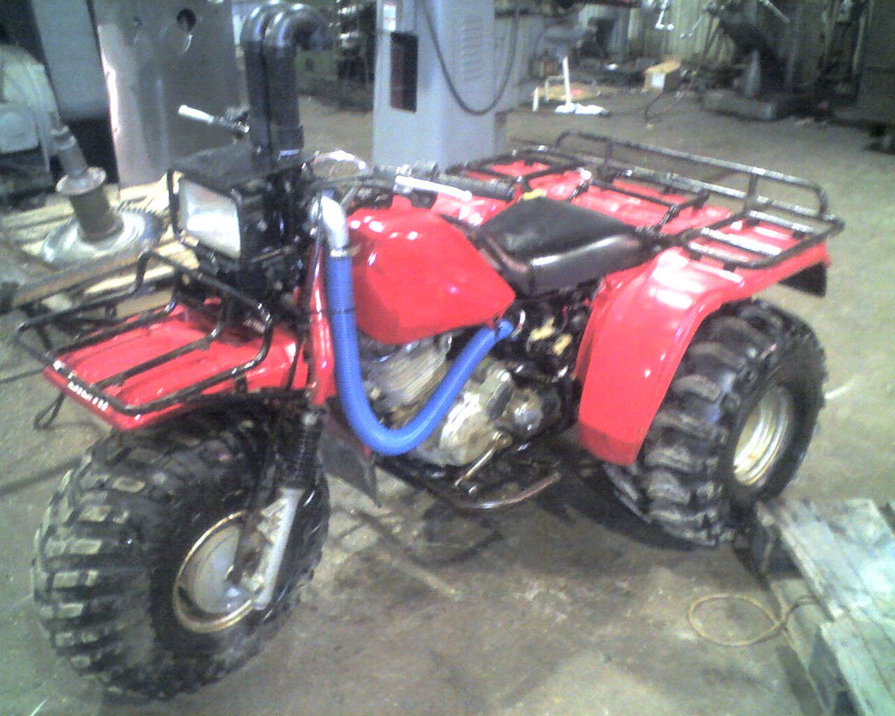

Anyway, me and my buddies has a favorite riding spot in LaPlace known simply as The Spillway. Its maintained by the South Louisiana Trail blazers if anyone wants to look them up. Next to the parking lot at the spillway is a drainage ditch that I've seen many guys swamp their biked in, si I figured I might as well give it a try. To make a long story short, I swamped mine too. Water in the crank case, the whole deal. Heres the video. http://www.youtube.com/watch?v=YpqefMA8Ak4 (I made multiple attempts at increasing speeds, but it started getting dangerous, so I let the ditch win this time)
So to solve the problem, I snorkeld my bike of choice, an '85 Big Red 250. I ran the vents for the crank case, rear end, carb, and rear brake into one snorkel and my air breather to the other. Tell me what yall think.

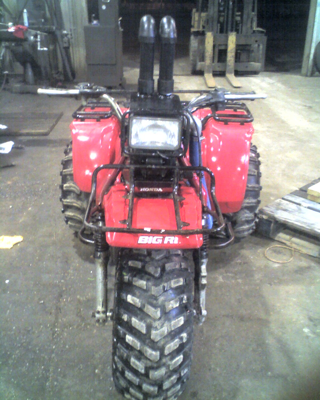

Can i ask how you mounted your snorkels on the front?
Zeus
Posts: 1505
Location: 'Straya, C*nt
Considering Biggsauce last visited this site in 2011, I really doubt he can. Fortunately I can tell you. Chuck a hose from the air filter to some snorkels, then magic them onto your handlebars, and enjoy.
