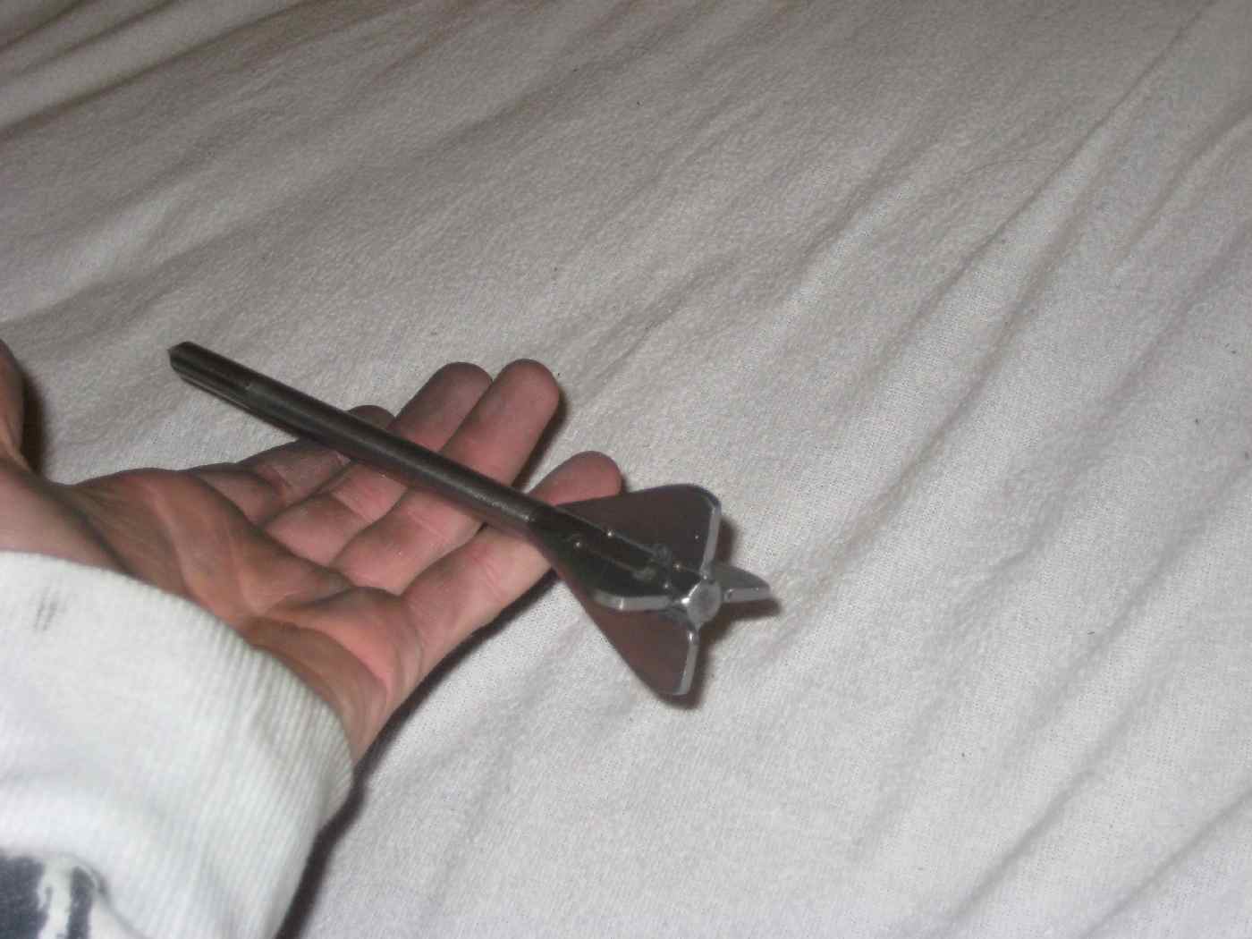

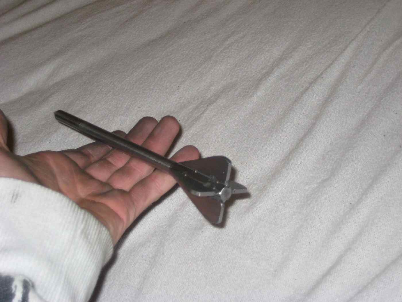

This is the most stable/effective round I've been able to make with simple household tools and materials:
Please note that this design is not suitable for hybrids, due to its extensive use of tape. Using a wooden plug behind it, this 50mm round worked fine at 500psi.
cannon monkey
- Posts: 399
- Joined: Sun Sep 07, 2008 10:50 am
- Location: usa FL
lol ya that dart spike think kinda toooo dangerous for where i live but thanks any ways XD
I'm a little unclear on what the sabot is made of, is it a wrapped cylinder of duct tape cut in half or something? The inner part is obviously a pipe segment. And what are the relative masses of sabot and projectile? Duct tape in that quantity is very heavy, so aren't you wasting a good bit of energy accelerating it? Apart from that, looks pretty fearsome.
Yeah, the tape does waste a lot of energy - I could only get this design up to about 600-700 fps out of the SCTBDC at full power. However, as I said, it's with basic tools and materials. With a lathe, and access to some strong, lightweight plastic bar stock, your range of options is much larger. This dart worked well in terms of accuracy, stability, and sabot separation, but it wasn't hardened, and could be stopped by 6mm steel plate.I'm a little unclear on what the sabot is made of, is it a wrapped cylinder of duct tape cut in half or something? The inner part is obviously a pipe segment. And what are the relative masses of sabot and projectile? Duct tape in that quantity is very heavy, so aren't you wasting a good bit of energy accelerating it? Apart from that, looks pretty fearsome.
