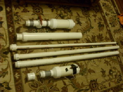

Brief history of my spud guns:
1st Gen: Ungainly 2ft 4" chamber with badly sealed spark wires. Parted out. Fired intermittently, Hair spray fuel.
2nd Gen: Interchangable barrel and straight or U adapter, still ungainly 2ft firing chamber. Sold. Fires reliably, Equate deodorant fuel, consistent power
3rd Gen(pictured): High pressure(non combustion) 1ft chamber with discharge valve, interchangable barrels and chamber.
Other chamber is 1ft, generic Right Guard fuel, spray 'n' pray(unreliable fire/power).
Assembly adapter(U or Straight) was destroyed by the lawnmower, so it's not pictured.
(From bottom to top)
Third generation, 4x12" combustion chamber with thread adapter for no-interchange assembly
2" Spud and mini-tennisball Cellular Smasher*
1 1/2" thinwall Golf Ball Barrel (perfect fit, raquetballs too)
1" This Looks Like a Weapon barrel(mouse balls, bolts with 3/8" rubber foot for semi-attached wad)
3" Anything that Fits barrel(lost the wad)
~145PSI 1-gallon pressure tank*
*Google video of pressure shot with 2" barrel
http://www.youtube.com/watch?v=VHlR5U-gBaA
Barrel-Tank Interchange System Spud and Product Accelerator

it looks like he has a ball valve pneumatic and a spray and pray combustion, both with interchangeable barrels
(BTW the above assessment is correct about what I had)
Arranged with the seal cap facing forward with the barrel and a short length opposite barrel on a 'h' joint makes an ok simple shoulder rest.
That placement also makes it ideal to avoid injury when the thing blows apart on you!
The end thread adapter, kept from the "1st gen" spray and pray(which worked a lot better) shot off on me! Apparently I hadn't followed adhesive protocol as well as I do now, and the recoil from 2lb of pvc shooting off knocked me over, in addition to snapping my jaw hard enough to chip a tooth.
I am well enough educated to know better than trusting plastic and glue to contain an unpredictable explosion, and am lucky I didn't get burned or worse from it. I'm moving to full pneumatic(hybrid is too expensive) and the physicist in me said they don't need a huge tank(1/4 barrel volume) if they handle high pressure(steel, 200+PSI) and the result of that is a very quiet launcher. I'll repost once I get pictures of it.
