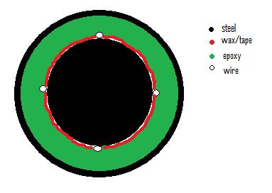

The way I was thinking of doing it you wouldn't have to unscrew the mandrel because you're not cutting the rifling into it, but building it up with something that isn't permanently fixed to it, like tape or wire with tape or wax or something in between. It can just be pushed straight out and then the layer cleaned out with heat or a solvent.
I think the diagram I have would work, but it would be difficult to get a consistent layer between the wires. Maybe paint that wouldn't stick very well to the steel or epoxy?
If the wire is exposed only 1/3 or so and you sand the back of it I think it should stay fixed in the epoxy. But maybe round rifling wouldn't be enough to engage the projectile.

I would work but if you have a tight fit with your projectile it will wear away the barrel and make it useless. I think just buying a barrel would be far more effective and last longer than one made from epoxy.
Interesting... what if you used a soft-ish mandrel, and wrappd the wire tightly so that it bites into the mandrel...
I agree that for .177, .22 or similar it would make sense to buy a barrel. But this would allow you to use 9mm or .50 pellets, or larger if you're launching something else.
Soft eh...something like a pool noodle?
What about a rubber hose over a pipe. If that wasn't soft enough you could do a layer of that foam weatherstripping tape that is adhesive on one side, and rubber over that, because the foam wouldn't be smooth enough by itself.
If you put a lubricant between the rubber and the core, it should be possible to pull out in two stages, even with the wire tightly wound.
