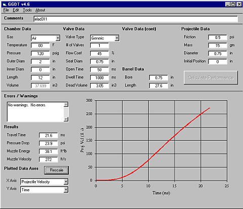

Well, Those are my plans for my first pneumatic cannon:
Well, do you think It's good, Will it be powerful?

The basic layout is OK. The chamber is 2" diameter by one foot long? The barrel is 3/4" D by 27.6" (70cm) L. The C:B ratio is 3.1:1, so the chamber length could be cut in half with only minor affect on the gun's performance.
GGDT says that for a 15g round, assuming a 50mS valve opening time, the muzzle velocity would be about 270 FPS. The actual valve opening time will have a large affect on the gun's performance. (You'll get ~340 FPS if the valve opens in 20mS.) Ball valves and un-modified sprinkler valves open pretty slowly which is why the predicted performance isn't all that spectacular.
I would move the pressure gauge to the fitting between the chamber and valve. It'll be safer there and less likely to get banged up as you handle the gun. And, the double thickness (pipe and fitting) will make for a stronger connection that is less likely to leak. I would also put the fill fitting near the gauge.
