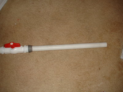

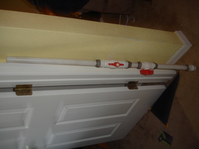

whole gun
whole gun

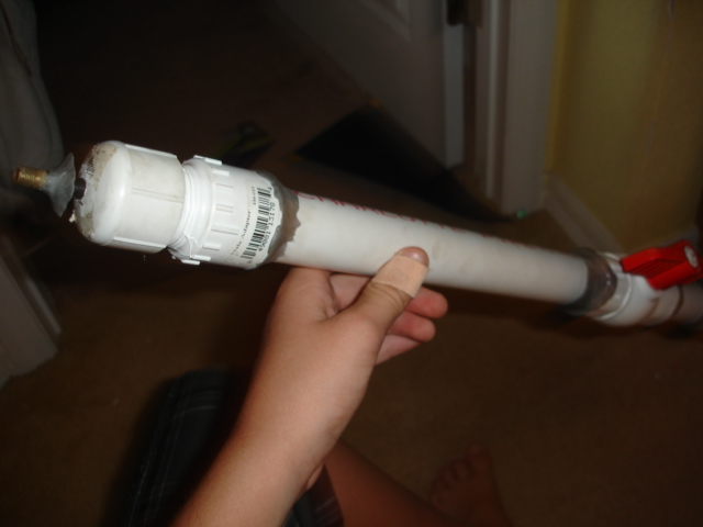

this is the schrader valve for charging

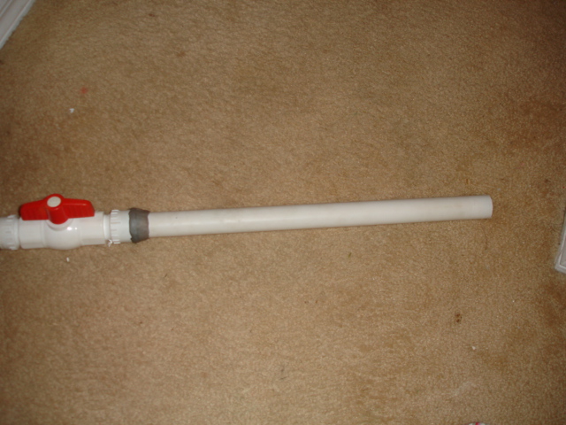

this is the barrel, and the firing valve

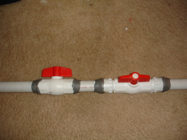

left) is the charging valve, it keeps the air in a large tank, then you open and close it and it delivers air to the firing tank, so you get about 5 shots from one pumping session
rp181
Posts: 1090
Is that epoxy putty holding it together? And how powerfull is it with such a smll firing chamber? WTB Damage pics :)
covey12
Posts: 260
yea its epoxy, im looking for that color paint that looks military green, like the kind on real panzerfuasts, it shoots about 300 fps on 90 psi, thats what i normally use goes about 20m. and like 1000fps at 200psi(complete overkill to use if your pissed at the other team :twisted: ) ill pu some pics of some ammo i use and damage

Ehhh, that's pretty cool...the whole big tank/little tank thing. You do realize each shot will get progressively less powerful don't you? If you could somehow get a regulator between the big and little tank and limit the shots to say 20-30 PSI, you could get all consistant shots, save maybe the last one. Also if you had made the big tank even bigger with a larger diameter, it would last longer still.
But, it's simple and reasonably effective. The epoxy is probably a little overkill, but it actually seems to give it a little character.
