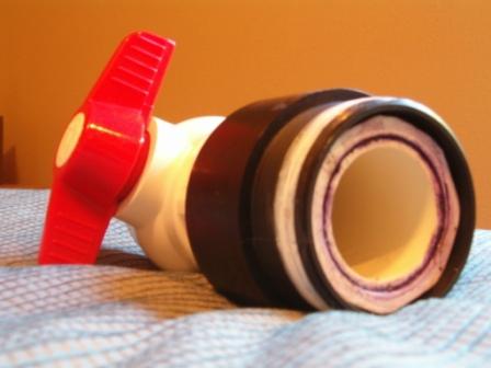

You guys are probably wondering how I attached the ball valve so here's my explanation... the ball valve is PVC cemented to a 2" piece of PVC pipe which runs pass a modified 2" ABS bushing. On the other side of the bushing inside the chamber, is the other half of the ball valve that was sawed off. This is cemented onto the 2'' PVC pipe on the other side of the modified ABS bushing. This can be thought of as securing a bolt by screwing on a nut on the other side of a piece of wood. The 2" PVC pipe is glued to the the ABS bushing surrounding it with JB Weld.

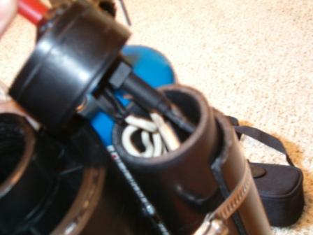

One thing I like what I did was how I stored all of the electronics. I managed to stuff the BBQ igniter, fan switch, 9v battery+holder,and the ignition and fan electrodes. I did all this without having a spark from the igniter jump, by dividing the entire pipe with a bit of thin poplar wood. To secure the electrodes (small bolts that go into the chamber) I had to drill on the other side of the pipe so I could use a screw driver and that is why I have a section of 1 1/2" ABS pipe over the electronics tube.

- This shows how I attached the PVC ball valve to the ABS gun...
- Ball valve attachment method.jpg (17.73 KiB) Viewed 3769 times

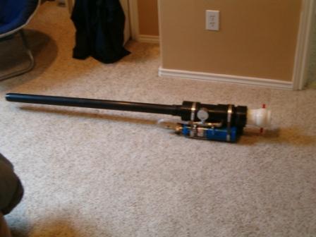

- Here's a view of the the entire thing
- First combustion cannon 007.jpg (19.72 KiB) Viewed 3769 times
- Here is the igniter end of the tube and you see the positive and negative wires on each side of the poplar divider
- First combustion cannon 006.jpg (19.5 KiB) Viewed 3769 times

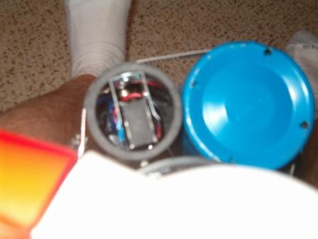

- Here is the battery end of the tube where you can see the 9v in its seat
- First combustion cannon 005.jpg (16.13 KiB) Viewed 3769 times

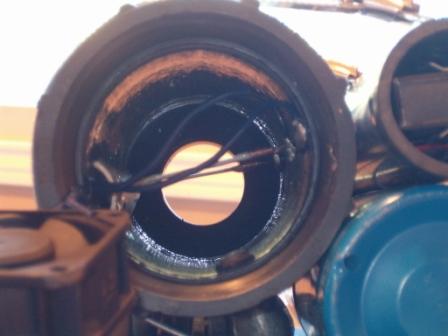

- Here is the inside of the chamber where you can see the chamber short on the left and the electrodes and spark gaps on the right
- chamber short 002.jpg (18 KiB) Viewed 3769 times

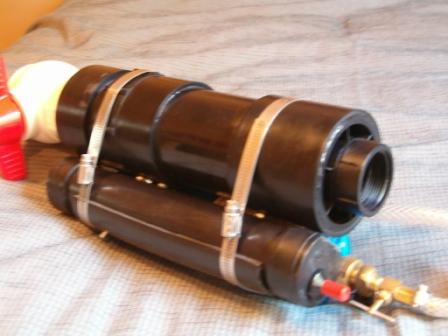

- Here is the side showing the electronics tube, igniter, and fan switch
- First combustion cannon 002.jpg (21.91 KiB) Viewed 3769 times

Not a bad effort, especially for your first combustion!!
The chamber/electrical pod/propane tank "bunch-up" looks, well, like a bunch-up...missing a defined structure. The pressure gage looks like it isn't readable in the position it's in and the big ball valve air inlet in the rear is way overkill size wise.
However, my guess is that your shots are consistent and powerful if your meter is designed correctly. A longer barrel, maybe another foot or 2, no more for practicality reasons only, would offer another noticable performance increase.
