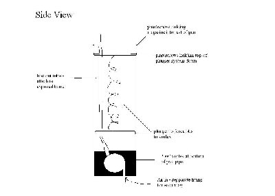

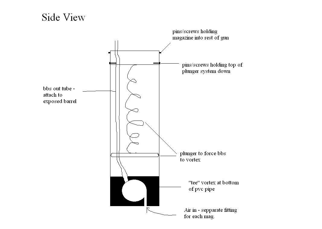

I've noticed a few people trying to design an easily replaceable magazine for their BBMG. I ask: Why can't you have the best of both worlds?
I realize there are some problems that will have to be worked around, but the basic idea should work. This is just a rough design.
- A pin holds the magazine into the gun.
- Two pins/screws/whatever hold the top of the plunger system so it doesn't go flying out of the magazine.
- A "tee" vortex block is positioned at the bottom of PVC pipe
- Air fitting is attached to each magazine. (I'd use a quick connect on each, and just plug in the air source directly to the mag)
- Instead of having the barrel coming directly out of the vortex, a tube comes out and goes through the bbs/plunger system.
- The tube is made to bee able to fit over whatever you're using as a barrel. The barrel should be able to be seen from the (magwell? - can't think of right word right now) The tube simply slips over the barrel.
- bbs will go through the tube just as if it were the barrel directly, and make their way to the barrel.
- There will be some blowby due to the larger diameter of the tube, but it should be minimal because the bbs will go through the smaller diameter barrel.
I don't have much time right now because of school, but as soon as the semester ends in December, I plan on trying this design out.
Until then, feedback/comments/possible improvements would be greatly appreciated.
I apologize for the crappy drawing. I spent about two minutes in paint doing it, and the late nights are starting to make my hand less steady. I just needed to get the design out of my head before I forgot it.
- ISA_Yoshi
Plunger Tee Vortex Magazine

why dont you put the air input the same end as the bb output, mor length for the bb to be accelerated, air has greater effect, less air consumption (more bb consumption however.)
This is instead of the air coming in from below.
Is there any reason for why this might not be practical?

SNDM:
Like I said, this was a quick sketch. Changes can be made to the design. Anyone who makes this can change whatever they want. I won't be able to actually produce this for a while. I was just putting the idea out there.
As for practicality: multiple vortex blocks (one in each magazine). It's more the pain of having to make a block for each than impractical.
Would the air input directly under the bb out tube be more air efficient? Higher ROF?

hi, My vortex Cap design allows magazines and you only need one vortex cap.. This just looks like its over complicating things to get the same effect.. replaceable magazines with a vortex system. I would suggest looking at the RC-P240 provided here:
http://www.spudfiles.com/forums/rc-p240 ... 12907.html
The vortex cap allows "easy to make replaceable magazines". The magazines simply snap down into the vortex cap. The vortex cap magazines are also portable because they have a pin that holds the bbs in untill you insert them into the gun...
So what does this design do that my vortex cap design doesnt?
I say keep trying to come up with some good new designs but really make sure to look ever the previous designs carefully first.
I have two BBMG designs, The vortex Cap, and the Direct Feed BBMG..

I'm not assuming you are an idiot. I'm offering advice which is to look at other designs to help yours out.
You said, "I've noticed a few people trying to design an easily replaceable magazine for their BBMG. I ask: Why can't you have the best of both worlds? "
That lead me to beleive you havnt seen a BBMG design that has replaceable magazines. So I was just giving you advice to look at the vortex cap design which offers removable magazines.
I don't claim to be always right but I will always give my advice on designs. I am not gonna say it looks like a vortex block and be done with it. If I see something wrong with a design I am going to mention such problem.
I am not trying to ruin your expierence on this site. But this site is educational and I hope you take peoples advice and criticisms about your designs. There are problems with all of my designs and I always try to take peoples advice on how to fix said problems.
Since you are new, and you made it sound like why cant we have replaceable magazines with a vortex system, it made me believe you didnt see my design (vortex cap). You did mention on how you seen my design with the highcap airsoft magazine but thats a completely different design.
So I stick with my original suggestion which is always try to learn as much as you can before posting a design and always be open to criticism and suggestions of your designs.
I hope I didnt ruin your expierence on this site but If the design has been done before and the previous design was more simple I'm going to point out there are easier ways to do the same thing whether its my design or not.
