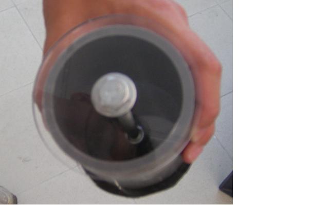

The piston from the rear. I forgot to add another rubber disk to the back. The beige thing is my hand. You can't see the nuts from this angle.

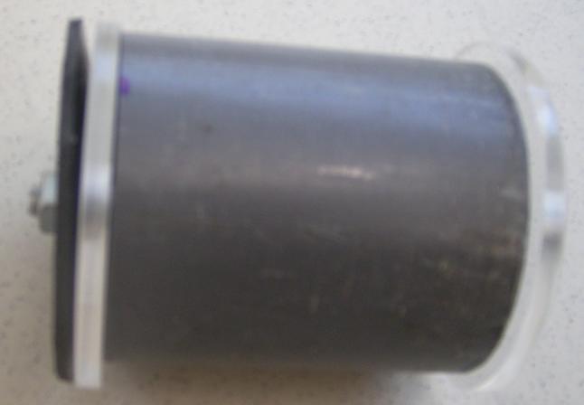

The piston from the side view. From left to right, nutt + washer, rubber disk, 6mm acrylic disk, UPVC JIS AE 3" pipe, 6mm acrylic disk, washer + bolt head.

That looks like a good start, although the brittle acrylic might not fare well under the forces incurred by the valve's operation, so be careful when you're testing it.
Remember that the forces on the pistol will be transferred by compressive forces along the length of the piston, so if you haven't already, I'd recommend making sure there are nuts on the bolt which can cope with compression loads as well as tension loads.
Of course, if the piston's interior isn't entirely airtight, these problems will be lessened by some balancing pressures inside the piston.
Good start - now test it!

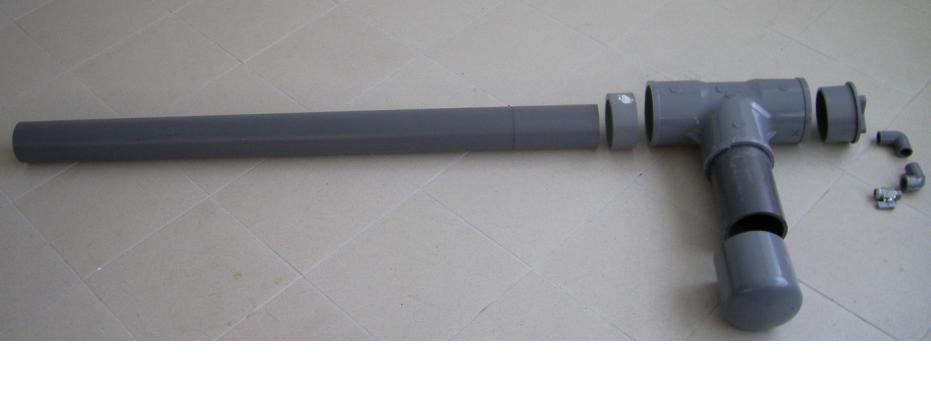

This is a picture of the cannon. Barrel diameter 3&amp;quot; JIS AE, tee size 4&amp;quot; JIS AW, pilot valve is JIS 1/2&amp;quot; ball valve.
This is a picture of the cannon. Barrel diameter 3&quot; JIS AE, tee size 4&quot; JIS AW, pilot valve is JIS 1/2&quot; ball valve.

The disk on each end look bigger in diameter then the piston body. I for-see a problem with the sealing disk catching the cylinder while opening, piston tipping and so forth.
For your sake I hope I'm wrong because the above sernerio will cause catastrophic failure at 100psi.... :shock:

jrrdw was correct in that the disk would catch the cylinder while moving back. Operationally, not too bad a problem, it just means that I can't fire with the cylinder pointing downwards.
Ideally, I would go try for the best possible / foolproof cannon, but I can well put up with the inconvenience for the time being until I make a better one.

The problem is that a large part of the piston overhangs out over the cylinder. So the front part of the piston does "drop" into the cylinder - and the part of the disk sticking out hits the rear wall of the cylinder.
