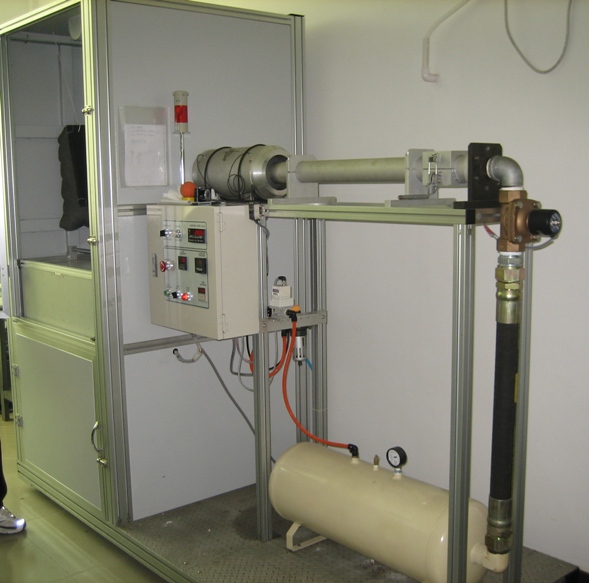

I'm building a pneumatic gun for use with lacrosse balls that needs to hit 60-100mph, which will then hit a target approximately 2-3 feet away from the end of the barrel in a chamber. Yes, this is my job :)
As this is being used in a place of business (granted, in a warehouse), safety is a primary concern. Space constraints are also important.
I've played around with GGDT and came up with the following, all pipes pressure-rated PVC. Lacrosse balls are just under 2.5" diam and weigh ~140g (5oz).
Barrel: 2' x 2.5"
Orbit WaterMaster 1" Sprinkler Valve (or similar, modified for blowgun trigger).
2gal capacity tank with 1" fitting (PN #9888K11 at McMaster)
1" fittings from tank to
2 90 degree elbows to get an over/under setup, various connectors.
Now, the issue comes in that I also need a 3" diameter barrel for field hockey balls (diameter of approx 2.8-2.9in).
I also need relatively quick loading - due to space constraints, it will be hard to muzzle load.
so, for the TLDR crowd:
QUESTION: What's the best option for combine fast reload where muzzle loading would be difficult in addition to replaceable barrels in 2.5 & 3" diameters? Would rather not have to get TOO much custom machining done, but a little is acceptable.
bonus question: GGDT says my needed velocities are quite achievable, but is there a more robust valve I should be looking at instead of the iffy sprinkler valve mod?
Picture is of a similar setup, but far more advanced that I need to go (if I had infinite cheap labor and a bottomless parts budget mine would look a lot like this though!). Link goes to another similar setup, although I'd like to compact it a bit. http://www.soimpact.com/1Cannon.jpg

Biged uses exhaust pipe on his bazooka, (2.75" exhaust pipe has a 2.625id) along with a sliding breech cover for ease of loading.
You might have to have an bushing made (check stock od's) to weld on to the end of the pipe and convert it to 1"npt, but it should be an effective solution.
A second barrel for the 3" could be similarly fashioned, and simply threaded into place.
Any muffler shop should be able to help you out with the sliding breech piece if you decide to use exhaust pipe.
Biged's bazooka and mortar can be found in the pneumatic showcase section.
